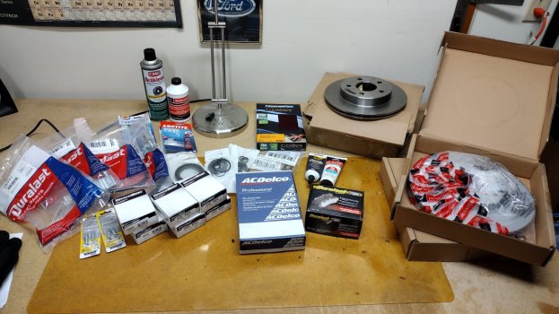

Beautiful car. Not a ton of great pads available for the rears of these.
Went with the Duralast Gold Semi-Metallic for the rear pads.
They don't make Gold's for the Sport fronts, so went with the ACDelco Professional Semi-Metallic.
I wanted more than just basic SM, which is why I chose them. I have no idea how good they are or how long they'll last, but I typically pop for Motorcraft or higher-tier products for The Car. There aren't too many factory original Sports in this condition around any longer, so I keep her in the best shape I can.
