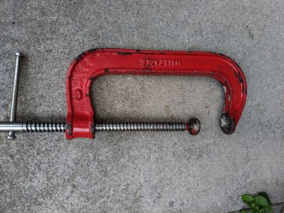

Installing them, every time. I have been known to wedge the open end of a wrench between the ball joint and sway bar to provide enough pressure to keep it from spinning as I tighten it. Then as it gets tight I'll pull the wrench out and finish torquing the nut down. For the spindle side I usually don't have an issue because there's a vertical load on the stud that keeps it from spinning. But if I do I bust out my trusty C-clamp.

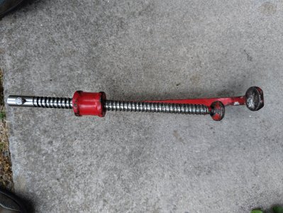

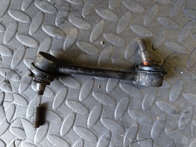

They came out of the holes really easily. I had to busted out my c clamp too. This is what it looks like now:
