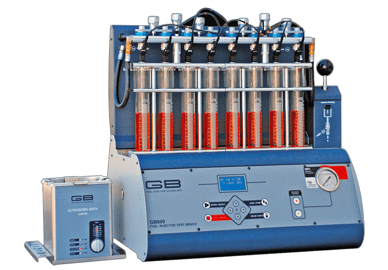

To be fair, its really not rocket science. If you already have the cleaning machine that plugs into the major injector options, running the test is automated and probably only takes <10min per set of 8. swapping out the caps and screens probably takes 5 min more so including packing, maybe 20-30min of work max with over half of that period automated.

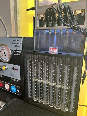

Here's a company (no idea if they are any good) that discusses their tests.
This ebay vendor seems to offer a similar service
The machine itself looks to be $250ish + <$100 in fluids so they are making money, just not a ton of it.
