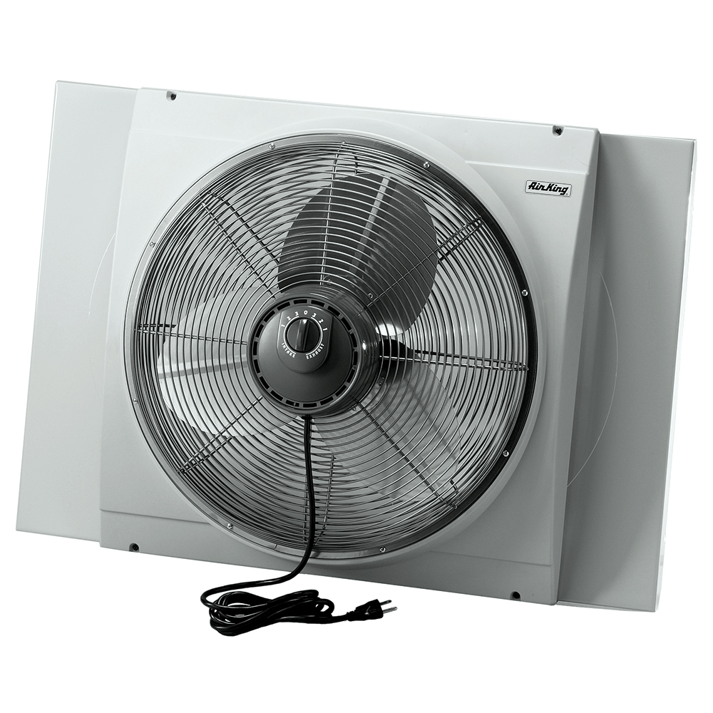

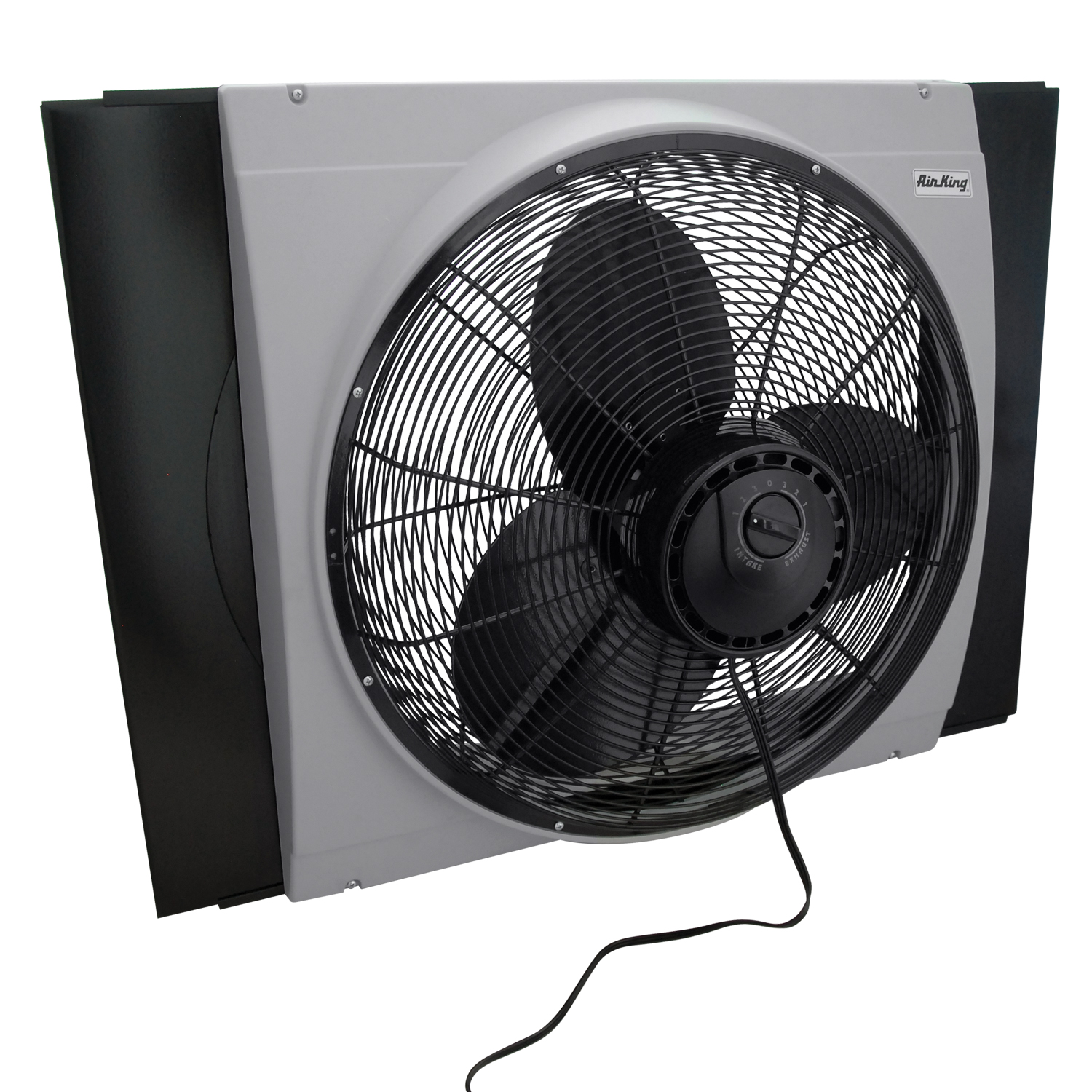

I have the 9155. And it works! Easy install if you have a window in the garage. I like that I can bring fresh air in as well as exhaust. This fan works so well the door will open if it's not latched due the suction.
That looks like a nice option.

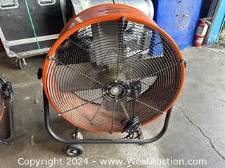

Are there any industrial equipment auctions near you? This is from a prop house downsizing their collection of junk
