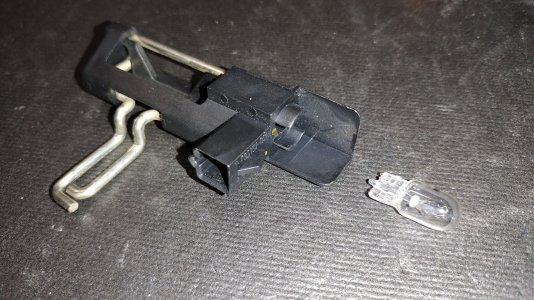

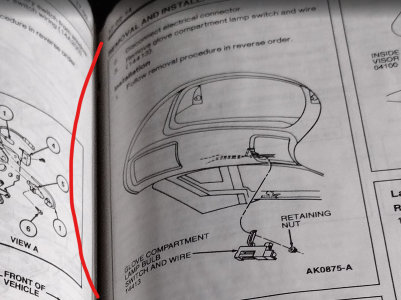

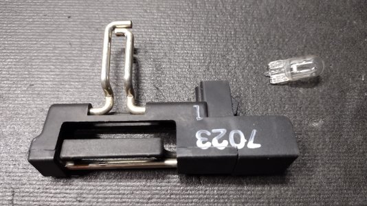

    In case you're still struggling to remove that glovebox bulb (standard 194 bulb), I can tell you how to easily remove it.
    I just removed mine, because I'm replacing the bulb.
    I had to do everything by feel, because it's too tight a spot to see what you're doing:
    1. You need a 1/4" ratchet, 10mm socket, and small worklight.
    2. With your left hand, feel your way from the bulb to about the middle of the black bulb assembly, then follow it towards the front of the car. Do this slowly, since we're only talking about feeling our way around millimeters & centimeters of area.
    3. As you feel your way through there, you'll feel about a half-inch of exposed screw and the retaining nut holding the assembly together.
    4. Now that you know where the nut is, feel your way to attaching the 10mm socket, then slowly ratchet the nut completely off...and the assembly will fall out a bit, still being held on by the electrical connection.
    5. Now that you can see the gray connector, very carefully use a small flathead screwdriver to unhook the connector to separate it from the assembly...then it'll be free to remove from the car.
    6. To remove the bulb, use the same flathead screwdriver end to very carefully pop the bulb out of the socket.
    7. Replace bulb (standard 194 bulb) and reverse the instructions to put everything back together.
    EDIT: I forgot to mention that re-installing the black assembly holding the bulb is a bit of a PITA of trial & error. Although it's just one nut you're dealing with, you'll have to play around with the alignment & depth of the black bulb assembly to get it in the right position, so that the glovebox door closes properly and flush with the trim panels.
    Attached photos show the black assembly that holds the bulb and the diagram from the Ford Service Manual.

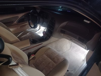

    Here's my dash with LED lights in the floor, dash, dome light and shifter indicators. I pulled the floor mat for this picture. The factory carpet is still in mint condition underneath. I've used Weathertech floor-mats since I bought the car new in 1994. This is with my old Sony head unit. I've since replaced it with a Pioneer. Also, swapped in the 145 MPH SC speedo.

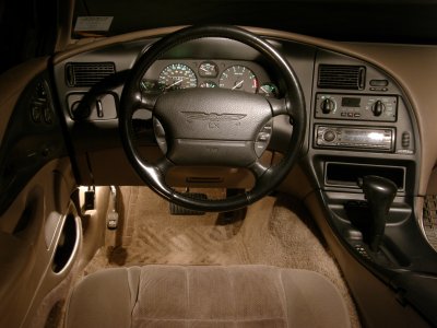

    Here's my dash with LED lights. I pulled the floor mat for this picture. The factory carpet is still in mint condition underneath. I've used Weathertech floor-mats since I bought the car new in 1994. This is with my old Sony head unit. I've since replaced it with a Pioneer. Also swapped in the 145 MPH SC speedo.
