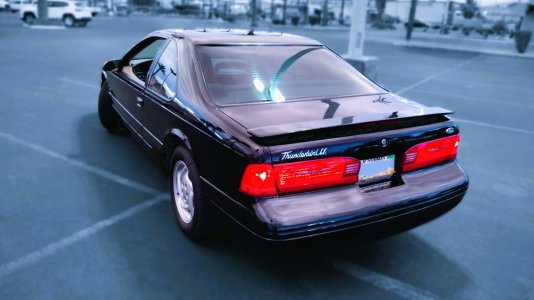

I have a '97 Sport with the factory wing.
I'm trying to figure out how to remove the 3rd brake light red lens embedded into & under the wing, so that I can replace the bulb.
How do I remove that lens without damaging it? I can't see any screws holding the lens to the wing, so figure it's being held in by tabs and snaps out (like the vanity mirror lenses). If so, where & how exactly do I pry it free without breaking the lens or tabs?

The factory bulb IS an LED. As for removal you really need to take the spoiler off first, then there are two round clear red caps you need to pry off and then underneath them there will be Phillips screws. Once those are removed the light comes out as an assembly along with its pigtail/connector.
Now for the pitfalls, the trunklid studs and nuts that the Phillips screws screw into are molded into the fiberglass and if there’s a hint of rust they’ll probably spin. Soak them good in penetrating oil for every step. Also once you get the light loose I recommend tying a wire tie to the electrical pigtail before you pull it all the way out and leave it in the spoiler when you remove it completely. Later when you reinstall it you can then tie it back up and pull it back through without hassle

921s are for the standard third brake light in the package tray on cars without the spoiler, so the service manual is technically correct for most Tbirds but not applicable for the sport spoiler ones.
If the LED is working definitely leave it alone as yes it’s a proprietary design. If it failed you could probably make a universal LED strip work but wouldn’t be worth the hassle if not IMO
