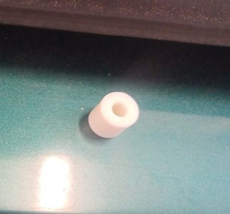

Obtain a nylon spacer. Length 0.5", outer diameter 0.5", and inner diameter I believe is 0.194".
The length being the operative measurement here, 0.5" is a good place to start. 1" is likely too much, and I couldn't find one at 0.75" (though that may be ideal).
Obtain one small zip tie.

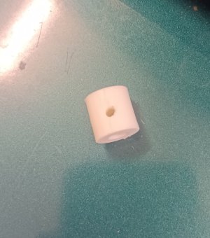

Drill all the way through the spacer using a 1/8 drill.

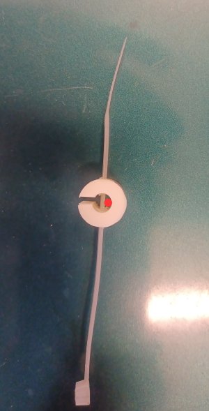

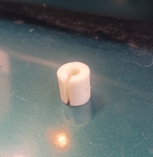

Cut an opening along the length of the spacer, 90° from the holes you drilled.
The cable will slide through this cut. The zip tie will prevent the cable from sliding back out.
In the following pic, the red dot represents the throttle cable:

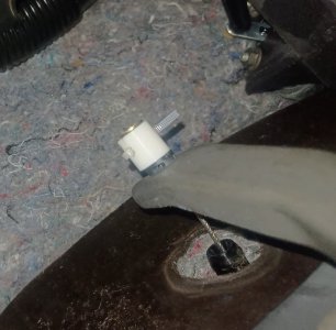

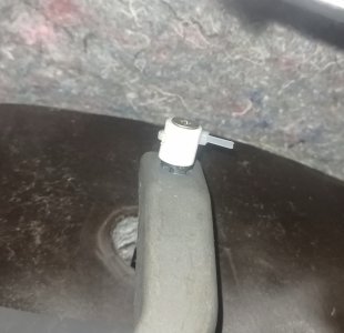

Install the spacer over the slack of the cable. Insert zip tie; ensure that the zip tie passes the cable on the side of the cut through the spacer. Close the zip tie; it doesn't need to be super tight.
The Result
Since the pedal below the mounting point is at least twice as long as above the mounting point, the half inch adjustment above moves the pedal at least an inch closer to the driver's foot. In my case, under full throttle the pedal sits just shy of the carpet.
