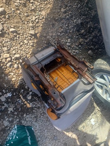

Manual driver seat track. Rusty but fully functional. Do I just need to take the tracks or the whole seat pan (for power to manual conversion)?

I think all you need is the seat track for power/manual conversions.

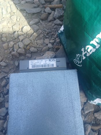

I had the idea of trying another PCM, but this one shows some corrosion. Makes me wonder if it's worth it.

Well, I installed the PCM at the junkyard and drove home. About 30 miles, mostly expressway, some suburban roads. And...
The car feels completely the same. What an experiment. At least shift points are exactly the same from what I can tell. Idle seems less rumbly, but maybe that's a placebo effect (?).

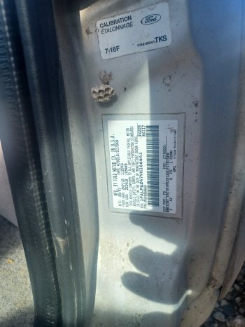

Based on the door sticker, I have an older tune. But my PCM was a remanufactured unit, so the actual tune may not match the sticker. The junkyard PCM has a newer tune per the sticker (the one from the torque converter shudder TSB). Also, I think the junkyard car does not have a NY/CA tune which mine does.

No, I mean what do you expect to break? They use the same MAF and injectors so there’s no potential for over/underfueling so it’s perfectly safe.

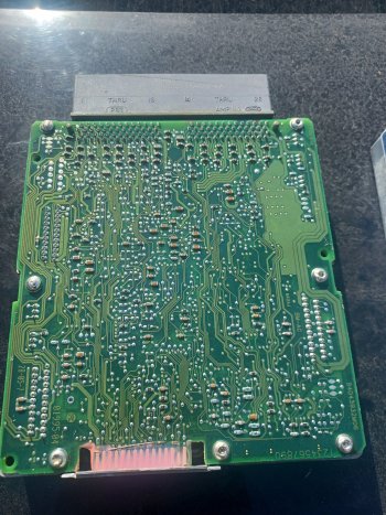

Those 2 eecs differe in that the one has no conformal coating covering the pcb. It would be sensitive to wetness. Humaseal works well if you want to coat it. Someone went to a lot of trouble getting it off.
You mean the top one doesn't have the coating? Yet that's presumably a completely stock unit. The bottom one is the remanufactured one that came with my car.
In person, there definitely is  some coating all over the junkyard unit. But it's not as thick as on mine.
If the bottom one is the remanufactured one it has the shiny shimmer of the coating, it could just be the way the light is hitting the top one where it looks bare
More pics of the top = junkyard = presumably stock unit.

Now I have a few questions! :biggrin: The catch code on mine is different than the one Martin picked up, SPP4. The door jam sticker on mine is also different, mine is 6-16T. I've looked at RockAuto and they list 2 different codes, the one with the T and one with the F like the picture Martin posted. What's the difference with all this, anything?

T and F are the difference between CA and 49 States (though my car originated its life in NY which apparently already used CA standards back then).
My car also has the older door sticker...but that doesn't prove anything.

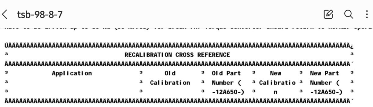

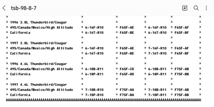

Here are snapshots from the torque converter shudder TSB. Note the old vs. new calibration numbers.
Screenshot_20240430_172723_Samsung Notes.jpgScreenshot_20240430_172742_Samsung Notes.jpg
