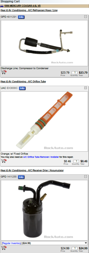

The AC leak in my Cougar recently got really bad. I can hear it leaking out of both the High side and Low side valves when I unscrew the plastic caps.
Plan is to get a vacuum pump and gauge kit and fix it myself.
Any other parts I should replace while I am at it?
Should 8oz of PAG 46 be enough oil?
Just my opinion, but I would replace the other hose as well, and also any O-Rings you can get to. I think they sell a kit that has O-Rings for the whole system. I think 8oz is the entire system capacity, so you won't need all of that. I used to have a chart that had the amount to add when replacing certain components, but I cannot find it right now.

I've got a kit of the purple EPDM o-rings, planning to replace the ones I can easily get to

Well thanks for the help everyone! I ordered everything; it was about $240 total for the parts, refrigerant/oil, and vacuum kit/gauges.
