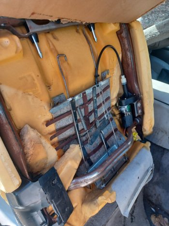

Answered my own question:
'97/'98 Mark VIII frame is entirely different and in fact doesn't use a bladder at all but an oddly flimsy looking mechanism.
I was going to say the Mark seats are a different animal, I wasn't sure if they used bladders or not as I never dug into them like that but by the way they physically operate the frames need to be specific. 86-95 Tauruses share the seat frames with the MN12s, bucket seat Vrown Vics share the same seatback frames as well
So that looks to be an electric solenoid that pulls a cable to bulge out the lumbar, interesting, it almost looks like a compact version of the parking brake system on classic cars. The Tbird and Cougar air pump isn't exactly the most elegant sounding thing so maybe this was a more refined and quiet system for the luxury connoisseurs buying Lincolns

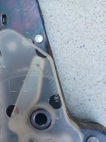

Meanwhile, I solved the mystery why my inertia switches don't work as designed. The original owner added a small spring to hold them forward.
Why in the world??!
Maybe that is a Lincoln thing. Both my Navigators '03 and '16 have a similar setup. I have found it can give a much larger amount of adjustment over the air systems in other cars.
