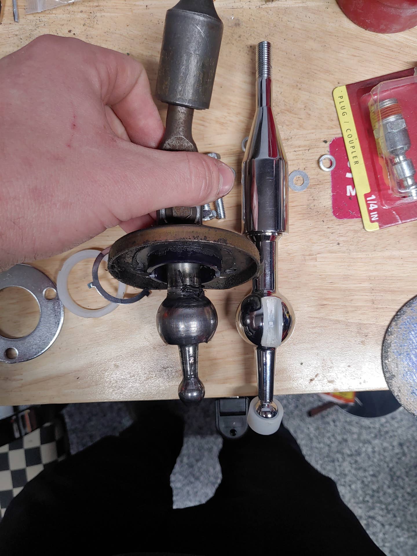

Out of the box, and having taken the OEM shifter out, I started noticing the differences.
The RX7s use a bushing. Now at least on my Bird, it doesnt. Take the bushing off and itll seem the same size but they are not. You will have to grind it down. I used a 32grit flap wheel on corded grinder.
(You are going to want to smooth out the finish. Doesnt need to be a mirror but dont have jagged edges. Itll eat the receiver.
Next thing youll notice is our birds shifter has two notches for the two alignment pins, while the Mazdas doesnt.
This is NOT an issue. The kit comes with a riser that will effectively work as a new pivot ball bore, and has a single adjustable alignment pin.

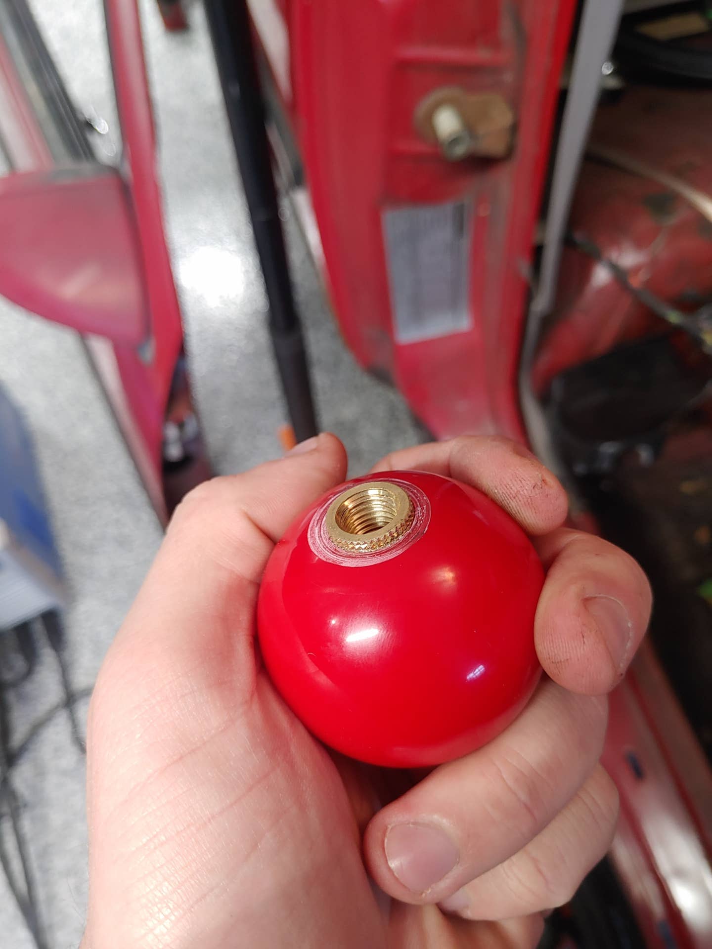

Also, the thread pitch is different. So you will either need a new shifter handle or will need to use an adapter like I did.

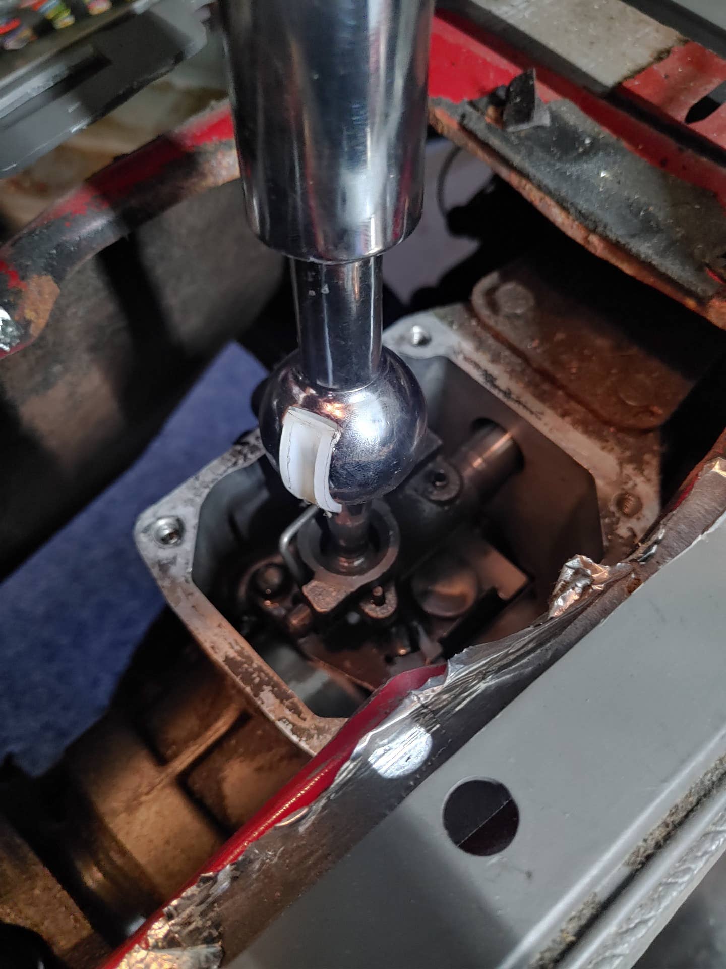

Moving on. The bore spacer only has a cut out for a single pin, since thats all the mazdas used. I pushed the front pin out just enough to drop the bushing spacer in.
Next thing I did was test fit the pivot spacer.
The bolt pattern was a little bit too small. So what I did was cut off the outside edges of the bolt holes, and from there it coulD match up.
From there I just assembled it as it was intended. Spring spacer, bushing (use the TBird bushings as they fit the pivot ball and bore better than those provided in the kit) shifter, top bushing, and then stock shift topper.
