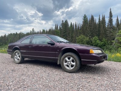

1992 Thunderbird Sport 5.0
Finally will begin my proper build thread :
I have had this car for a good bit now (3 years now in 2024) and have done a few mods to it.
First of all of the important stuff, Summer of 2021 I blew the automatic transmission and swapped in a 5 speed from a 1989 supercoupe.

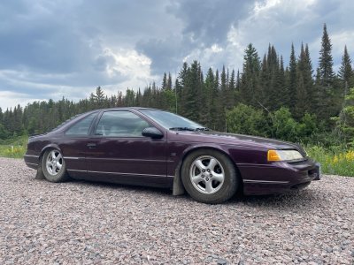

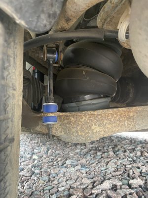

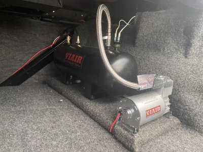

Second of all, I had put the car on air bags summer of 2023
Had the car running like that all summer 2023 and still running in 2024, whole system with plastic tubing, manual valves but I am planning on upgrading the system to a more reliable hard tubing and electronic valves and better gauges.

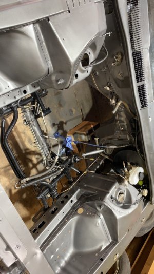

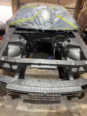

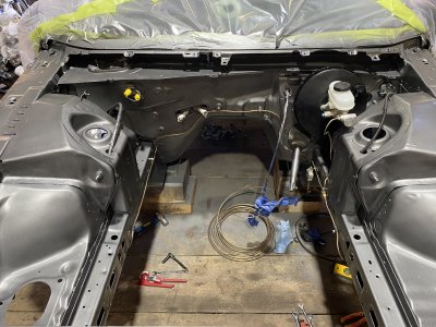

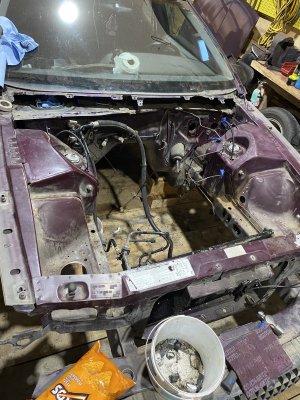

Ripped everything out, cleaned and scuffed the whole engine bay and painted it a graphite grey:
Turned out alright, I was really shooting for a gunmetal but out of a rattle can it was good enough.

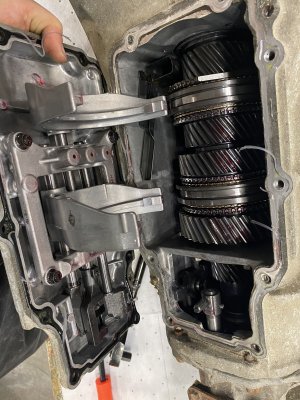

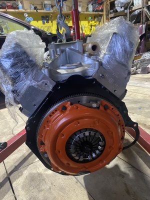

Next on the list was to rebuild the 5 Speed transmission, 1 for the fun of it and learning experience, 2 reverse gear was acting up, 3 I had everything out and wanted to put in as much new as possible.

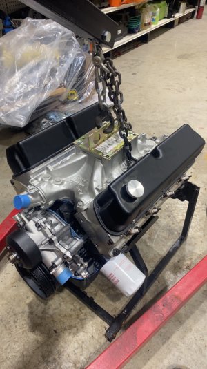

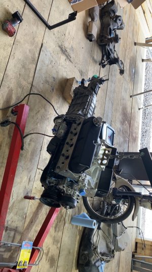

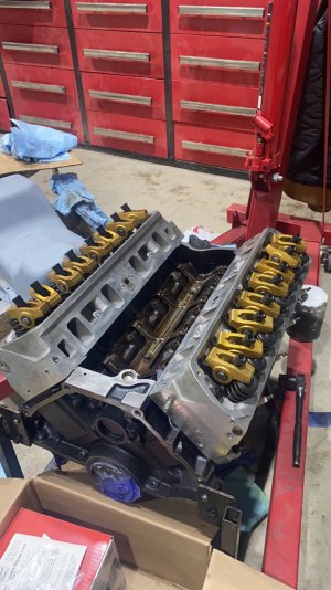

Once I had that done, I rebuilt a 5.0 HO engine out of a 1987 Mark VII, this engine had the mustang HO cam which I left in it. Rebuilt this engine, Painted the block and threw on some Holley Aluminum heads I had bought second hand and got resurfaced.
Heads came with roller rockers and double springs, had to get 6.400 pushrods I believe to match the heads geometry. After that I topped it off with a Holley Dominator single plane manifold and new water pump :

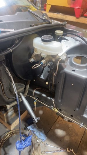

Next, I went from the ABS setup to conventional brake booster and cylinder, deleted all that junk and ripped out all of the wiring, depinned all the connectors, that felt really good :

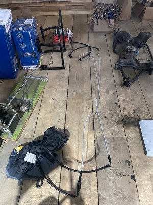

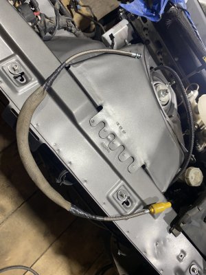

Also while I was at it I redid all the front brake lines:

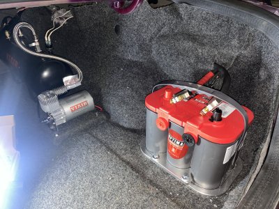

After the K member I did my trunk battery relocation:IMG_0526.jpeg

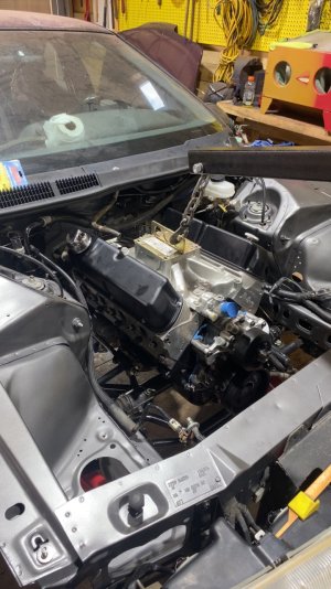

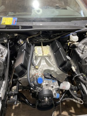

Threw the engine in:

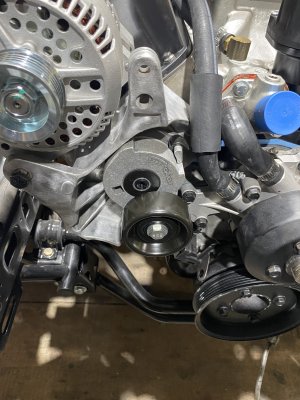

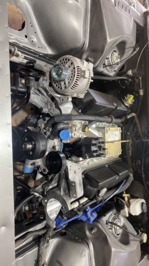

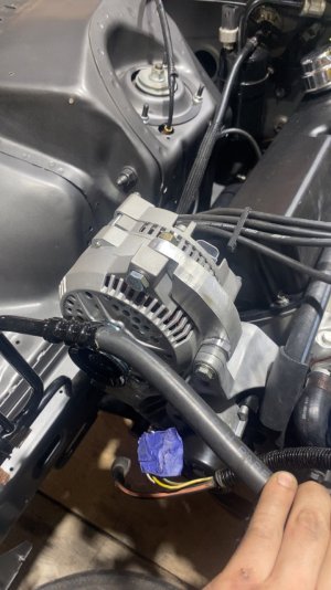

Added my accessory brakcets and my new SN95 130 amp alternator:
Got a new belt tensionner for SN95’s which is slightly different from the stock one but fits in its place if you grind down the locking nub a little bit. With my setup a 91.5” belt works but squeals alot, will have to try a shoter one to see if it gives more tension and stops squealing.

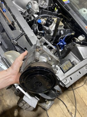

Painted the ac clutch which im keeping for now as a requirement from the gf:

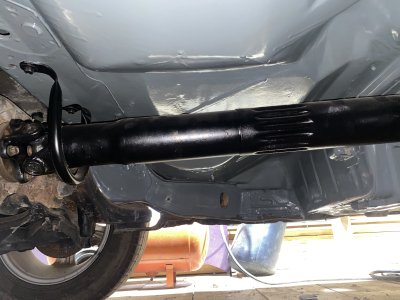

Changed U joints, Painted driveshaft and hoops. Painted with thick rust preventing paint above gas tank and inside tranny tunnel while I was here, the rest of the underside will be painted eventually.

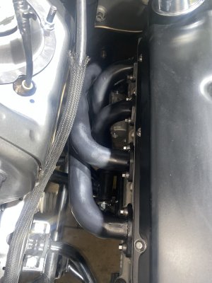

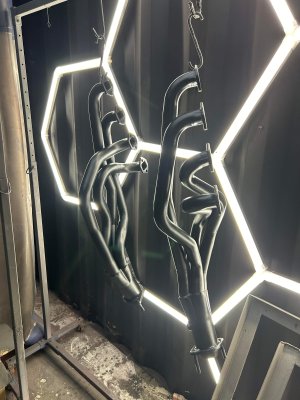

Got my set of long tubes ceramic coated :
Made an alternator bracket off the writeup for the 3g alternators:

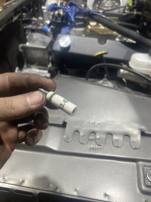

Went with E3 spark plugs which I managed to break 1 of them somehow:

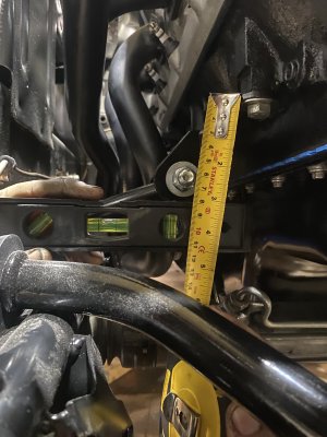

Figured out the AJE K member sits 1 inch taller than stock and seems to sit towards the front of the car more.

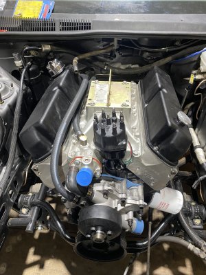

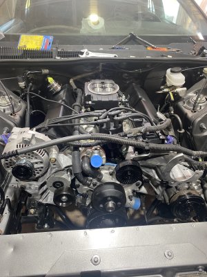

Installed power steering, spark plug wires and the cherry on top, the holley sniper efi!

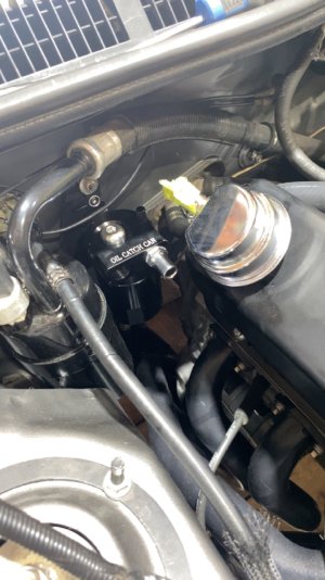

Installed the catch can:

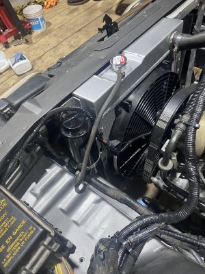

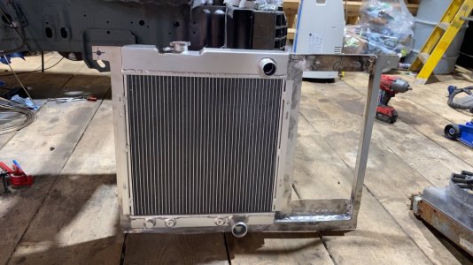

Made a custom radiator frame to fit my 1965 mustang rad and to fit my future intercooler ;)

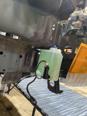

Hidden windshield washer fluid tank:
Part 4 :

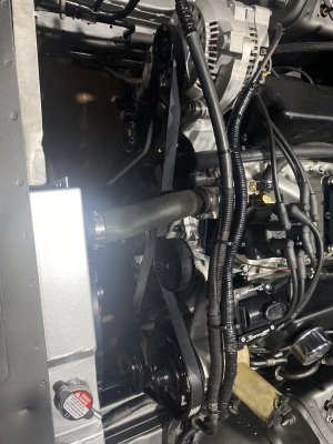

Cut the stock upper rad hose to fit my setup:
Flex-a-lite 3000cfm cooling fan and my new overflow jug:

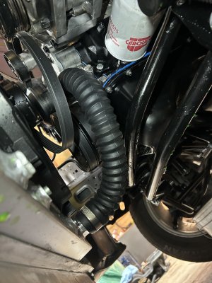

Continental flex hose for lower:

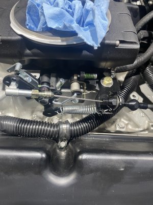

Lokar throttle cable and a spring to give me more pedal feel:

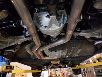

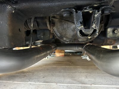

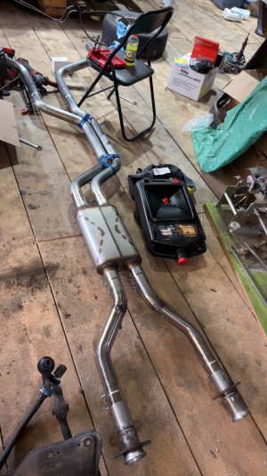

Stainless exhaust pipes, tru bendz exhaust kit and a black widow venom 250 muffler comes out to 3.5 inch tips:

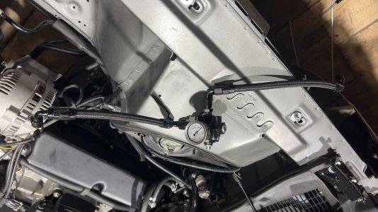

An6 fuel lines 3/8 aluminum tubing with a 340lph in tank fuel pump:
Found out the hard way the sniper efi 2 does not have an internal pressure regulator so I got the holley one:

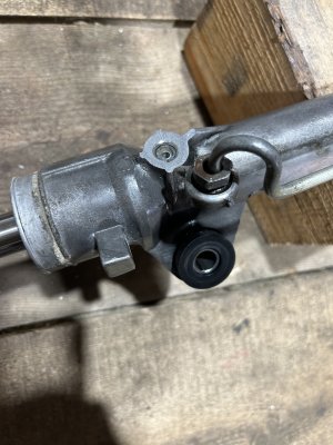

Was somehow unable to bleed powersteering, it was not working very good and I went and messed with the fittings on the rack and broke it :), got new power steering pump, rack and pinion and new lines and it bled great right away and works good! :

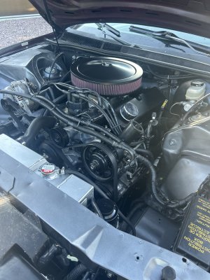

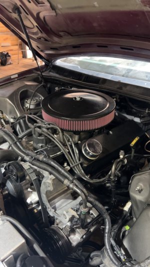

Got the k&n 2” air filter to clear the hood, still had to cut off a small section of support and rip out the insulation :

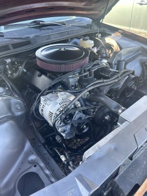

The current stage :
This was definitively a learning experience, had lots of fun, lots of thinking was done and lots of anger was released but the car is finally driving and has now sucessfully driven 500 km’s since this years build.

A single black widow venom 250 muffler is very loud, has a nice sound but drones quite a bit on the highway cruising.
Conventional brakes seem to work fine, no problems yet and the brake pedal feels good!

Not impressed at all with tru bendz and I do not recommend their kit, did not fit my fuel tank or diff properly, not sure if its because they falsely advertise that it fits the 92 as I know newer models have different fuel tank arrangement. But if I were to start over I would just buy the stainless tubes and bends and weld them myself as even their tubing did not line up 1 bit at the rear of the car and I had to weld and extension to move it over 5” to one side, plus it fits so wrong it sits under the diff and reduces geound clearance substancially.

You need the 93+ fuel tank with that exhaust. Any thought on putting high flow cats in to reduce sounds or drone? Small bullet mufflers may do the trick too.

Yes for the exhaust thats what I assume, it was just marked as it fits the 89-92 so I assume they must have made an error somewhere because it doesn’t fit good at all. I am thinking of replacing my exhaust tips with some sort of resonators or mufflers as my tips are 18” long.

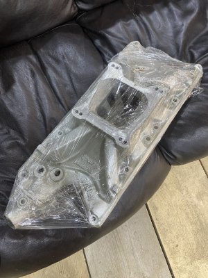

I was trying to find that intake for the RPM specs, but seems it's no longer made. There were 2 iterations with one having a divide in the bottom to help with lower rpm torque. Anyway, I'm with Mikey, it's certainly too much intake for the stock cam. A comp extreme energy in the 1500-6000 rpm variety will do well with those heads. I don't think you need a "boost" cam if you're not looking for a 700hp setup. Make sure to do your research on lifters, as there have been more issues in recent years, although roller lifters haven't had the issues flat-tappet have.

And yes I did weld up together my tru bendz exhaust pipes and not fully sure if I do have the early or later style tank but it really doesn’t clear the rear diff, one pipe lines up under the rear control arm mount and the other under the diff.

Yes that intake manifold seems pretty rare and really is hard to find info and even any comparable pictures of!

Something is definitely not right with that exhaust. Those pipes should tuck up between the diff and the LCA mounts on the subframe. I can’t see your tank in the picture, but the later style tank should have a recessed area in the middle slightly to the driver’s side to clear the exhaust. The early style tank is flat all the way across the bottom and the exhaust goes all the way out to the driver’s side rocker panel and around the tank that way.
I was worried I would have to add the v bend on the one side like the factory has to clear the diff but it fit great and the lowest part of the car in this area is the rear control arm mounts. I have the Tru Bendz 2.25" SS
I see no reason that the sniper would have any issues with a dual plane. Carburetors work just fine on dual plane manifolds, and back in the 80s when manufacturers were using TBI setups, they were all on dual plane style manifolds.
Okay so I must have the newer style fuel tank as it does have the exhaust tunnel, the thing is thought is that my exhaust is pretty centered and about 1/2” away from the heat shield towards the passenger side so i can’t really bring it any closer so I am not sure what is wrong?
What intake manifold should I get for my setup? Right now my research is hinting towards a Weiand Stealth or the summit version of it?
That looks like it will work well with your heads. I would probably spring for the Weiand over the Summit, unless you have nothing but time. In my experience, the Chinese knock-off manifolds usually require time porting, smoothing, and massaging to bring them up to spec of the manifold they are copying. If you’re only saving $50-100, I would rather buy the name brand part and not deal with that headache.
the QC on the trubendz is questionable to me to say the least, I got my 2.5” SS pipes tucked up nice but I took a cutoff wheel to the LCA mount and banged the heat shield into submission for the pipes to clear them, and it’s still a little tight in places
Yes seemed very tight, doesn’t fit good at all, I will have to modify them again to get my ground clearance but for this summer its fine, that will be for this winter/spring!
I'd be tempted to go with an Edelbrock Performer for your setup, and get a cam with the same operating RPM
Ive done abit more research and a weiand 8124 would probably be more appropriate for my setup I think than the stealth, and is supposed to be similar/better than an edelbrock performer. Any suggestions or comments on this is helpfull and appreciated!
