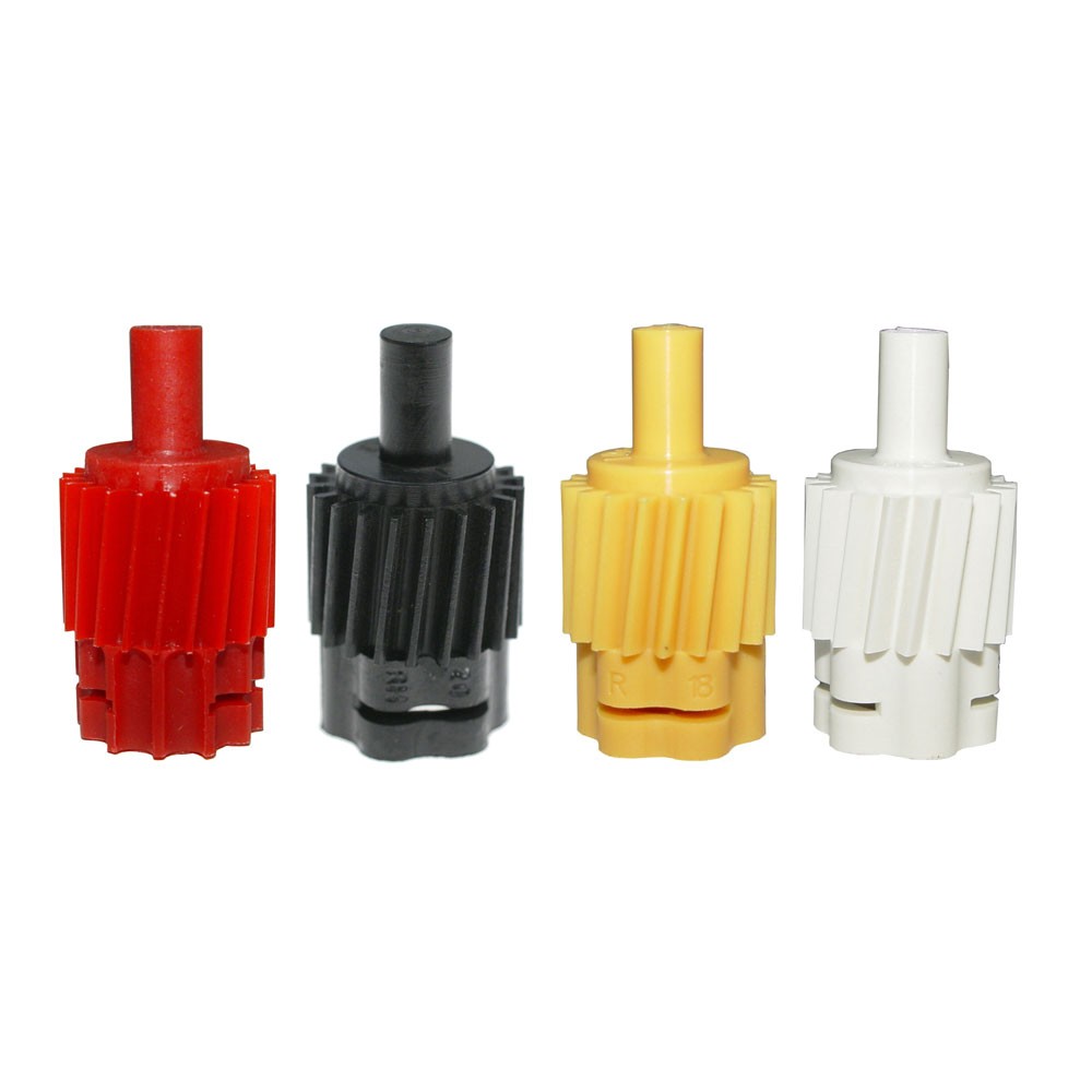

One last thing... the speedo is off a bit. Up to about 45 it is accurate. At 64 indicated it's going 60 according to the PCM and GPS. At 78 indicated it's going 70. Not a really big thing, just a bit annoying. I wish I knew how to correct it.

I missed the speedo; you need to replace the vss gear in the trans, it depends a lot on tire size. a 225 60r 16 needs a purple gear. You can buy those from the dealer, or online. it's about 5mph per tooth. The speedos are pretty inaccurate at 100mph, use a gps.

What size tires are on the car?
The formula is tire RPM (rotations per mile) * final drive ratio * OSS drive gear teeth (always 7 for an auto MN12 or FN10) / 1000 (e.g. 775 * 3.73 * 7 / 1000 = 20 tooth gear)

The tire size is stock, 215/70R-15. I have new Yokohama Avid Ascend tires. Just about 70 miles on them. I'm unimpressed. Since these are the size shown on the inflation sticker, would the speedo gear really need to be replaced?
Shouldn't be, presuming the rear end ratio and speedo gear are stock. It might be a speedo head issue; best way to confirm would be to read the speed from the PCM and compare it to the speedometer at various speeds.
Yeah, I've been doing exactly that. That's how I know the speedo is off.
From the original post: "Up to about 45 it is accurate. At 64 indicated it's going 60 according to the PCM and GPS. At 78 indicated it's going 70. Not a really big thing, just a bit annoying. I wish I knew how to correct it."

The mph readings you gave are the same as one tooth off. I'd change the gear before I took out the speedo.
Bought the Doorman Kit. Was told on this board that it worked great for 96 and below. Wouldn't have a clue where to get a new one with one less tooth. We ARE talking about the little gear right? Not the bigger gear that the little gear sits on?
He is talking about the driven speedo gear in the transmission. I believe you are talking about the odometer gears? I cannot imagine why your speedo gear would be incorrect, but it is possible. Might be worth pulling the gear from the trans just to see what you have. I think different 4R70W's had different tooth count driving gears so maybe somebody swapped in a trans from a different car at some point and just put the old speedo gear back in.
Yes, I was talking about the odometer gear. As for the tranny... I believe it's the original. I don't know how long the odometer gear has been broken or IF it was even broken when the car was parked but the odometer reads 94989 after the 74 miles I've put on it since I fixed the odometer gear. Many things on this car appear to never have been touched since the factory, however the intake is the aftermarket Doorman plastic. Everything I look at that is usually broken on cars with high mileage like locks on electrical connectors, trunk lining plastic nuts and the like...they are in good condition. It's not a guarantee, just an indication. I haven't had the tranny pan off yet, but IT is acting weird. Going to replace accumulators with the updated units, might consider a mild J-mod but parts prices have risen greatly since I did my first J-mod 20 years ago. Since I'll be in the tranny area when I change the filter, I could pull the speed sending unit and see what gear it has and verify it's correct. Thanks for the post.

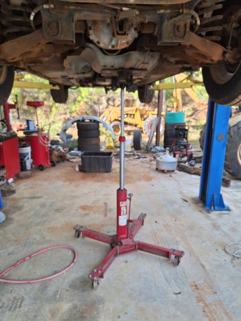

Tool the fuel tank out last night. Fairly easy to do using my lift and the transmission jack I scored for cheap at an estate auction last month. Looking for a new seal today for the fuel pump. Old one was too big and distorted when i installed it. Hope I can find one.

There is a run of fake walbro pumps out there; make sure you get a real one, as the chinese copies die quickly. We have a flow-thru system, so you can use a bigger pump than you need now, to allow for future expansion. :) They usually come with a mustang sock, but you can get the right one at autozone.
Should still be able to get the fuel pump lock O-Ring from Ford. I bought a three pack last time I did mine.
tre performance sells cheap china pumps and they usually last alot longer than the waibros. I dont do the walbros cuz they are loud. The cheap waibros are quiet but have a horrible dying rate as mentioned.
Replaced the pump months ago. Didn't get the seal installed correctly. Re-seated the seal yesterday and all is well.
