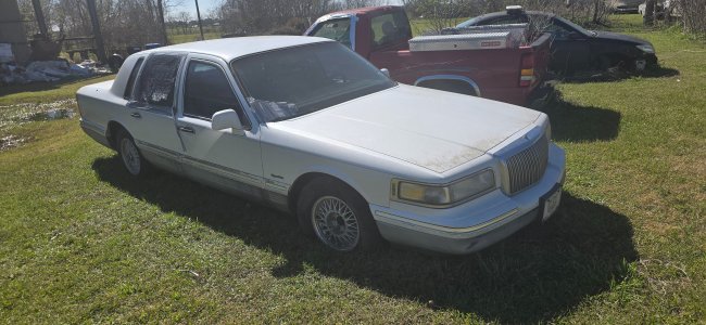

I'd say I'd be happy to travel to get the parts, but all my money right now is going towards getting a 97 Town Car on the road so that when I start working on my Tbird I still have something to drive(plus the passenger and trunk space are something I've needed and not had a few times). And here's a picture of that money pit for those who like Panther Platform.

That was the last "Stately" model TC, in my mind,v at least. Those limos were the coolest.
I never did like the ones after this body style when they got rounded off myself.
