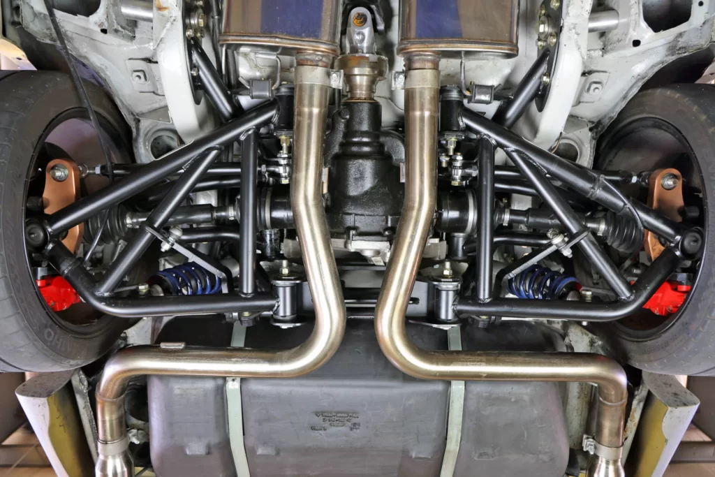

I've wanted to complete the 3.8SC swap with the rear suspension but want to maintain present wheels,, look. Problem is overall IRS width needs to be about 16" narrower than stock which means the CV boots would be contacting each other,,! Plus travel would be reduced to 6-7" and frame rails need to be moved inboard.
I think that's a light. :unsure::ROFLMAO:

Dang, I want a nice exhaust under my Cougar! I ordered OEM mufflers for my car that were supposed to fit the 4.6l dual exhaust and got the size of 3.0 bore (well, larger than OEM pipe). I had to manufacture reduction pieces to get the mufflers to fit the exhaust pipe.
Nice pipes 97!
