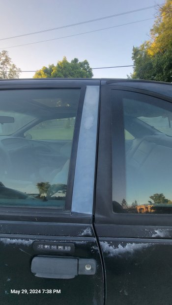

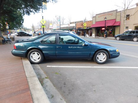

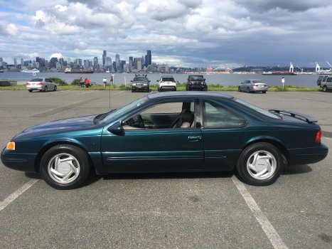

I got these pillar post covers off of Ebay about two years ago and I have to say that they have held up much better than I expected. I expected them to scratch easily or even come off, but no. They still look new and have held on very well. I do not think anyone (except you guys) would ever even notice.
Here is before:
Here is before:

3.5 years after install and still look new. What I like about them is you really don't notice them. Looks factory, maybe better than factory.

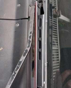

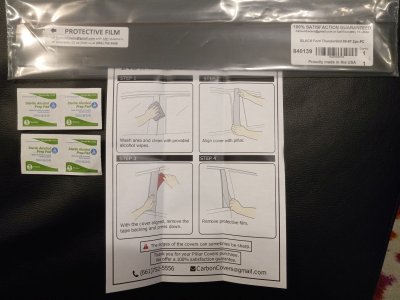

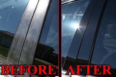

My ebay kit came in today and so I tried this out.
Very simple: just a couple of strips of material. I slid one beside my wiper and arm to give you a sense of how thick it is; the red is the cover protecting the adhesive on the back, and the grey is the material itself. It's definitely not some paper-thin thing.

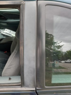

Before.

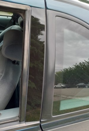

And after.
How is it? Well, you need to make sure you have that lined up right, because once that thing is on it is not coming off, even to adjust. Install was about ten minutes, most of that being opening the package and rubbing the pillar with the included alcohol wipes. Quite inexpensive, and as simple as can be, but again: be precise or you'll wreck it.
I'd say it's better than it was, but you go from undermatching (too dim) to overmatching (too bright). I prefer the shine over the dull fade, but I'd prefer something that matches properly even more. Still, it will do until I can get around to repainting the whole thing proper.
I prefer it matching but I agree compared to the usual dull alternative that’s better. I’m just conditioned by complacency, it looks good!
Be nice if they had a matte black version that matched the other trim.

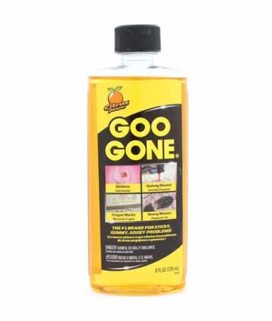

I thought that if I ever had to remove them I would be able to use Goo Gone. That stuff works on removing all adhesive, just let it sit for 5 mins. It smells great also. I've used it as cleaner too.

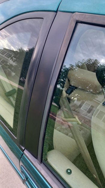

I used PlastiDip on mine. It's been months, maybe a year, and it looks flawless in spite of the hand traffic.
Your plastidip looks flawless and very factory. I however have low confidence that I could pull it off. The covers were easier for me.
