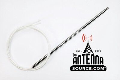

I managed to break my power antenna mast today (the motor still runs). As the original is discontinued, I'm wondering what people prefer as a replacement. Rockauto has Peterson black rubber masts, and Ebay and Amazon are full of similarly priced segmented steel ones. So the options are there, but I was wondering what people actually recommend, if anything.
I've had two of these on our '97. The current one stopped going up all the way after about a year. I just left it since I rarely drive the car and my wife doesn't turn the radio on much. Their language in the ad is tricky, but these are not OEM Ford parts. I considered just changing to a fixed mast antenna, but I honestly haven't had the ambition to search for parts. I also tried to find an NOS OEM mast, but could never confirm the part number. It may be and likely is the same across several platforms.
EDIT. I do see a Ford part number referenced in their ad: F3AZ-18A886-A
There are several listings for OEM versions of that part number on ebay for $55-$80. Most of those listings show it for a Crown Vic, but if you search on OEM Ford part websites they do show it fitting an MN12 (at least the '94 Cougar I happened to have entered in). I also found one on ebay UK where you can see part of the instructions in the bag and it lists several other applications like Mark VII and Mark VIII, so there is a good chance it fits our cars.
Buying direct from them rather than through their eBay store would be cheaper.
Here is another option from the same vendor if you want something less troublesome and dated and are willing to pay for it.
No way in hell would I consider an OEM fixed mast as a replacement, both from an aesthetic standpoint and because it makes the car too tall to drive under my lift unless the runway is all the way up (first world problems).
