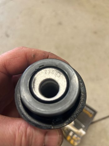

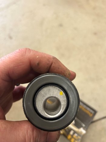

Here are some pics of the Dorman bushing. The packaging made it seem like they were going for a more upscale look to the part for whatever that means. The inner bushing does rotate relative to the outer part. It is pretty stiff. I had to insert a tool into the center bore and held the outer part with my hand. No way I could just turn it with my finger. In the end, as long as the inner bushing rotates and isn't molded to the outer then it should do what it needs.

Good to see Dorman is making the part correctly. A few years back it was hard to find the proper bushings.
