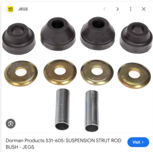

On the topic of the thread? does anyone know if these bushings are actually what they claim to be? i thought about ordering a couple sets just for the off chance these scp bushings explode or are too firm. These claim to be natural rubber like our oem bushings and look like it too but i wouldn't be surprised if i ordered and received the blue black thermogarbage
For the price it might be worth a try on those Mevotech ones and see what you end up with.
In 2018 bought a set of these discontinued Dorman bushings. I thought they might not have the split sleeves. I still have them in the box, they ended up being the usual cheap set unfortunatly.
I did order a set and I’m pretty sure they were rubber. I returned them because I lucked up found a set of OE bushings in an old box. My plan was to reuse the solid sleeve and not use the split sleeve.
