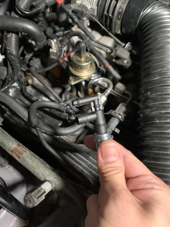

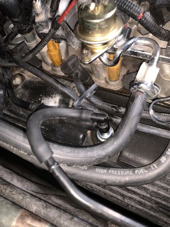

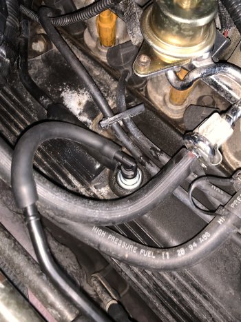

@supergordo took a look and recommended to change the pcv valve because it was leaking. It usually idles fine however, there are random times of stalling and it is usually fixed after restarting the car.

The top elbow on the PCV is the EVAP inlet, so any leak in the PCV is a leak from there as well
The car is actually in nice shape. Pretty nice interior. Great color. Control arms have been replaced which is nice. Needs an idler pulley, belt tensioner and belt. The vacuum line and the T that leads from the PCV to the T to the manifold is in decent shape. I think it needs a god throttle body cleaning. As well the stalling is probably a cheap IAC. I know Chris Murder will agree with me. The cheap replacement IAC valves for Fords rarely actually work right.

Those cars have some intricate passages in theTB egr circuit that are a bear to clean. It pretty much has to come off.
