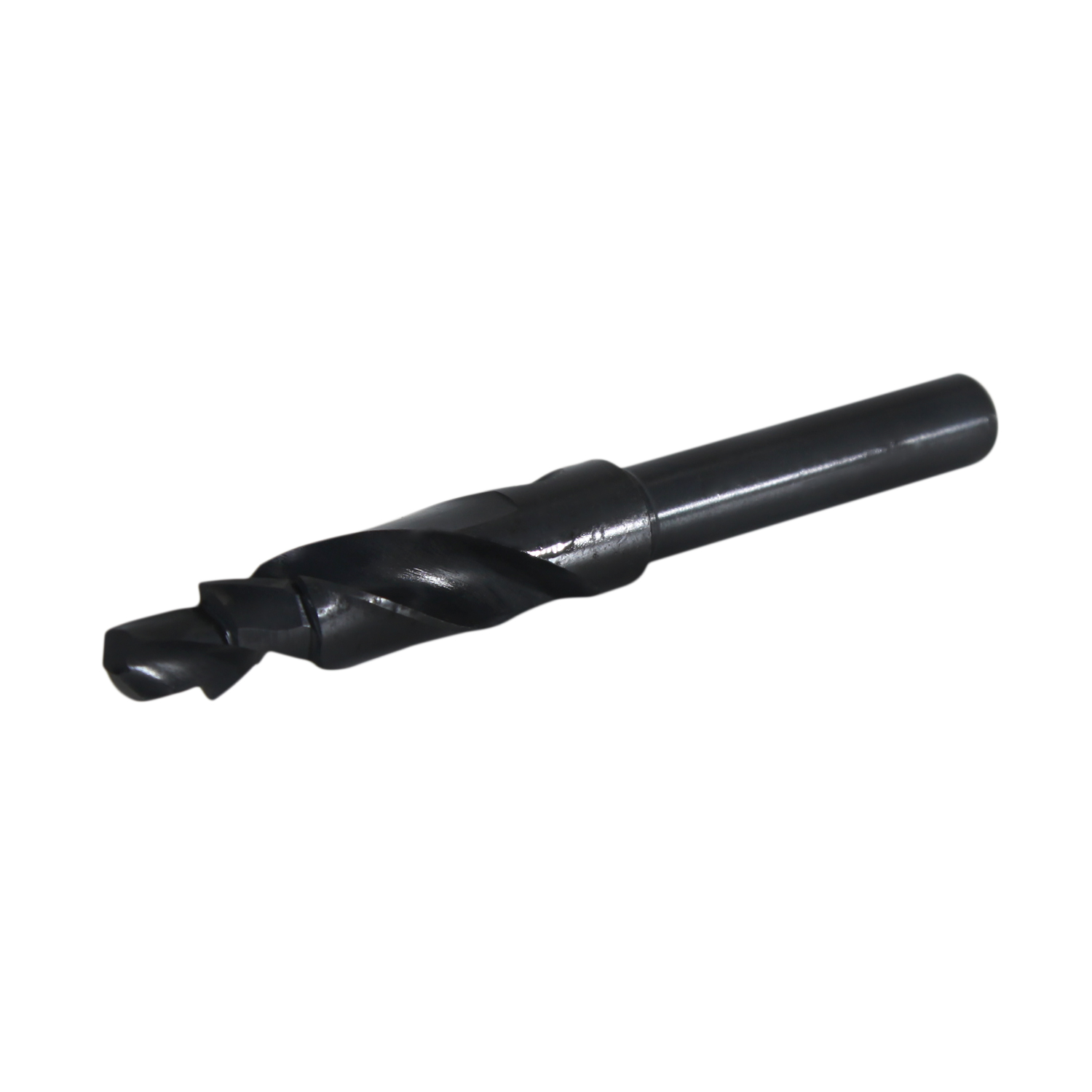

    I think the only thing I can't seem to find in print, is the injector spacing itself. Seems like I took a measurement before. Then I misdrilled the pilot hole, lol.
    Drill bit 79 bux.
