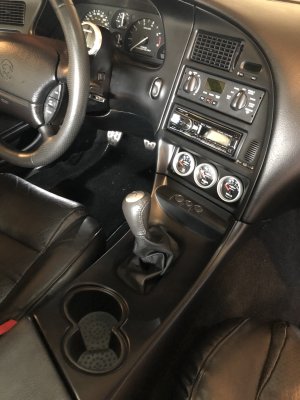

I have an Alpine in my Cougar and I like it enough, it’s similar style to that one and not overly obnoxious looking or hard to use like most other head units, but if you just want Bluetooth there’s always this…
I bought one of these for the Focus on a whim a while back and it works great, made me really question why I didn’t just keep the superior looking factory head unit in the Cougar since all I really wanted from it was the Bluetooth
Otherwise here’s basically how that alpine should look, only major difference is the CD player in mine rather than the media player.

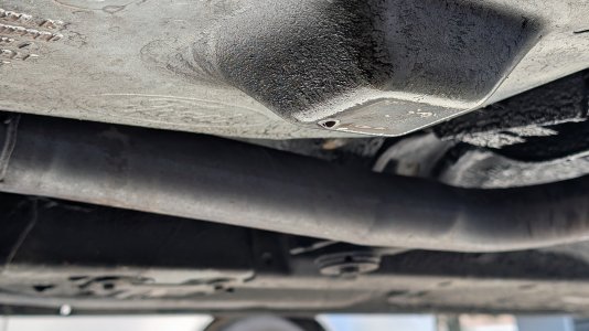

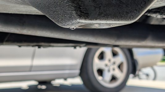

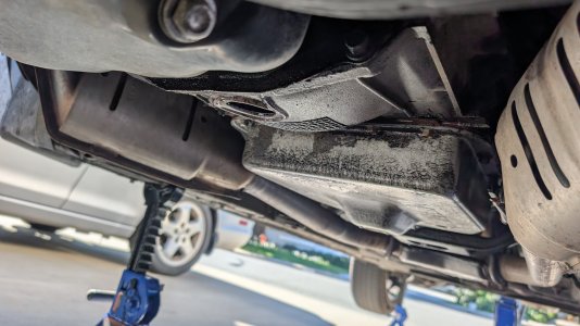

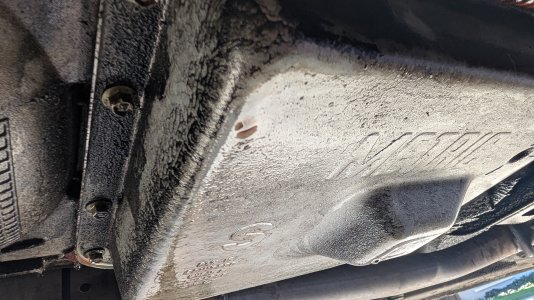

Currently in the middle of my oil change for Gold Bird, and the oil leak I thought I had, isn't an oil leak 😔. It's a transmission fluid leak, likely from the front pump seal as it's in the same fashion as it is in Dirty Bird.
I guess sooner rather than later, I'll be getting that Marauder / Mustang GT / MK-VIII torque converter and mild J-Mod done when I pull this transmission to replace the front pump seal.
Maybe I can save some time with getting the transmission from Dirty Bird rebuilt / fixed / looked over along with these improvements and throw it into Gold Bird 🤔. I hope I have more time before it's too far gone.
Agree with Joe.
Is there any dripping from the rubber plug in the bellhousing? If not, I would assume your pan gasket is faulty (possibly cheap aftermarket cork style?) or the bolts aren't torqued to spec.
I have an extremely slow drip from my bellhousing, but there are never any drips from the pan. I'm in the knock on wood stage still, hoping it won't worsen any time soon. I haven't had to add any fluid in months; I check it about once a month.
Thought I posted this one, guess not. Drips are visibly seen from the bell housing as well. Thought I had a better picture but I guess not. Rubber plug is missing and has been missing since purchase back in July.
PO did replace the ATF, so I'll check the pan as suggested.
I'll bet it's the seal on the manual lever, they wear. Get the dorman pan with drain, a filter, an oring for the dipstick tube, and the man lever seal. If you don't need the seals, leave them in your toolbox, for when you do need them. Post a pic of the pan magnet.:)
If fluid comes out the tc cover, see if the tc drain plug is leaking.
