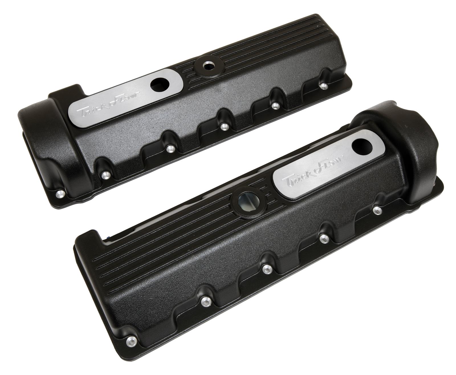

Trick Flow I believe is the only current manufacturer of aftermarket valve covers, made from cast aluminum
I have the trickflow valve covers and I’m planning on switching back to stock. They look nice, but I really don’t like the oil fill; the cap gets really hot when warmed up and the fill hole is so small you have to use a funnel every time to add oil.
I dont mind that. Better than the 27 year old valve covers covered in baked on grease,dirt and oil lol
Mine have never been cleaned in the cars life. And I'm not cutting them off for performance it's just cheaper lol
