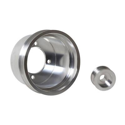

Question, would this underdrive pulley kit work on my 1990 T-bird? It says I would need a shorter belt but It doesn't say what size, what would I need then?I know there's some debate about underdrive pulleys but I figure any bump in power will benefit the 3.8. Thanks
I'm not sure of your answer unfortunately but I do feel it would be useful to other members to know is this a 90sc or is it a n/a 3.8? The belt routing is very different so I'm sure that's important
They really don't make any difference, you'll notice your headlights dim at idle more than any change in performance

Yeah, underdrives are only worth 1-2 HP or so; pretty hard to quantify because there are so many other variables that can lead to differences in power output (density altitude, for example).

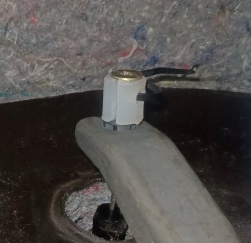

I did the elimination of throttle cable slack today. Apparently a very popular mod in the Mustang forums.
It actually makes a huge difference subjectively. The pedal sits slightly closer to your foot. As always, proceed at your own risk.
In my case, this worked great:
I took a half inch (I think) nylon spacer, drilled through it, and made a cut on one side. Then all I had to do was to slide the spacer over the cable slack aft of the throttle pedal. Finally, I put a zip tie through the holes I had drilled, which prevents the cable from sliding back out through the cut.
Quick update a few days later. I really love this.
I thought the effect would wear off as your foot muscle memory adapts to the higher position of the pedal; but that doesn't seem to be the case.

Where did you get the nylon spacer? I'm starting to get sold on this modification, def one of the first things i'm doing once I remove my car from storage.
Perfect, thanks. I figured that's where i would look first, and this might be a stupid question, but you said it was a half inch, was that a half inch long?
