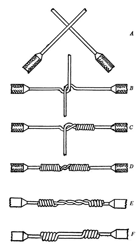

Here’s how I solder
Straight to the source nestled in the connector where there’s no flex point.
When I have to do inline splices I splice the two stripped ends parallel to each other like a Y rather than butt to butt and after soldering the twisted end I bend it into an h where I then apply the heatshrink tubing. It minimizes the stress area and allows flexibility. Ford EVTMs actually recommend this method with illustrations.
There isn’t one crimp splice on my car. I hate those bulky ugly things
I use method 1 on this image to solder in-line splices followed by heat shrink. All of my mods are done this way. Sounds like Matt does 3/4, which would require a larger heat shrink tube than 1. I just looked in the 1994 EVTM and didn't see the illustrations for this, but I feel like I have seen it somewhere.
Yep that’s it, mine are more like 2-4 but the end result is the same. I also strip back the other wire a little to get the splice more compact in the shrink tubing. Shrink tubing length is actually about the same. I have a lot of #1s still on mine too, but I just got out of the habit of doing them that way for the potential fatigue issue.
Yeah I use the "Western Union" splice method which looks like what Grog posted.
The speakers in the car now are Boston S-85. I think I paid a paltry $100 or so for all four 15 years ago. I did like cheap. :)
That's what I learned for inline splices as well. Lineman (Western Union) splice, solder, heat shrink. Those two wires are staying together forever.

What I found was that soldered wires, if they vibrated much, would break off right where the wire enters the solder. and IPC standards for thore connectors being soldered takes a special type of pliers to prevent the solder from wicking up the wire, making it break off. There's a whole stack of books on this stuff. I found a cheap universal crimp tool, with replaceable anvils to fit almost any crimp pin. $20. I'll post a link if anyone's interested.
You can tell if the solder is wicking up the wire by the insulation melting, The trick is to not be too liberal with heat and application, wrapping the single strand tightly around the terminal and stripped wire is more than adequate of an electrical connection in itself, lightly tinning on the solder at the very end of the terminal just keeps it in place, I never apply so much that it wicks up very much past the terminal, and yes I've tested cutting the wires to check. By the point the wire comes out of the actual plastic connector it's as flexible as the stock crimped ones. Every single connector on the engine harness I built from scratch 10 years ago has perfectly flexible pigtails coming off the connectors.
Doing the splice in the h shape works because the solder is all on that "tail" sticking up and over one of the ends, the wire two individual wires essentially have no hard solder in the line of the wire. Even the western union splice does that, the biggest advantage of that is you're not twisting the brittle little strands to pre-fatigue them like a simple inline splice
