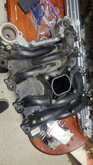

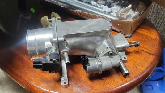

Well I found an oem instead. He only wanted 100 for it but I gave him 140 cause I felt like i was already stealing it at that point.1000012966.jpg

The intake on my car had a leaky crossover, when i tapped the second coolant sensor i just red rtv the shit out of that area under the crossover and it did fine. i wouldnt say its proper but the car was a rust box, doesnt leak a drop of coolant to this day, and now i have one with no cracks so i hope i have the same luck
