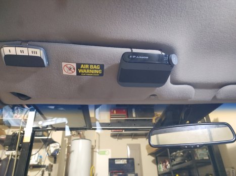

I got a new Bluetooth speakerphone for navigation readouts and calls.
View attachment 311View attachment 312
I recently looked at my options for Bluetooth because the Motorola T505 Bluetooth speakerphone I've had for years was made with that damned soft touch rubber coating that disintegrates and gets sticky over time. Also, it's the only remaining device I have that charges via Mini-USB, but most of all, I was not happy with the thing basically being covered in Spider Tack and it isn't worth my time to strip off the old coating.
I seriously considered upgrading my head unit from the Pioneer Premier DEH-P800PRS. However, the more videos and forum threads I saw about its successor, the Pioneer DEH-80PRS, the more I felt the build quality of the 80PRS would have been a major downgrade, all just so I could get built-in Bluetooth and Unicode support for USB file playback. Not really worth it. I'd rather get a DEX-P99PRS for the Unicode support over USB and keep the Avantree Roadtrip.
So far, the Roadtrip has been pretty good. First of all, it's not made of that soft touch crap. It has a replaceable Li-Ion battery cell which is a total surprise in small electronics these days. The audio through the speakerphone for Google Maps voice navigation is louder and clearer than the T505. Supposedly, pressing that call button on the right also invokes Siri/Google Assistant when not on a call, but I haven't tried it yet. I also haven't tried using its FM transmitter function yet because...well, who still makes phone calls?
It cost $60, so about double or triple the cheaper Bluetooth options, but I prefer getting something with English instructions and an original product design. Jabra and Motorola have left this dead segment of the Bluetooth accessory market and I don't want white-labeled junk with cat-on-keyboard brand names from China via Amazon if I can help it.
This feels like such a Luddite solution, but since I'm not going to downgrade my head unit, nor carve up my center stack trim panel to fit a double DIN Android Auto head unit, nor get a motorized flip-up unit (which are both head unit downgrades anyway), this is one of the few options left out there that fits my criteria.

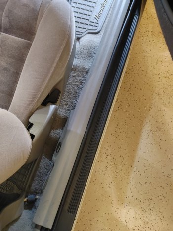

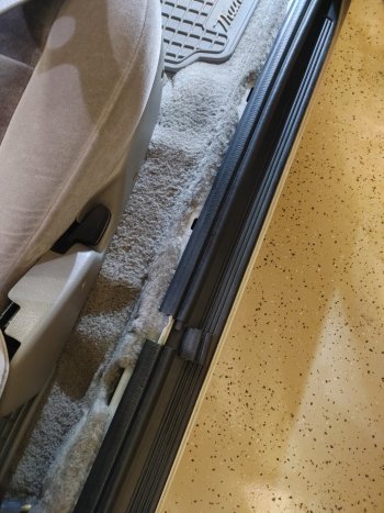

Both sides of mine were short about the same amount. I did the same as you.Does anyone else's car have such bad tolerances on the door frames? The perimeter of the door frame is 1.5" longer on the passenger side of my car. Between five different door weatherstripping surrounds pulled from junkyard cars, all of them fit perfectly on the driver side when tightly pressed in and were 1.5" short on the passenger side. It was always just loosely pressed in on the passenger side with it being pulled tight around the upper rear and lower rear corners to hide the 1.5" deficit. I only noticed this for the first time a couple of years ago.
I replaced the entire driver side surround with a good one because mine had a tear in it over a foot long. I cut off the torn section, then cut another 1.5" piece from the remainder that was in good condition, and plopped it in on the passenger side.
View attachment 336View attachment 337View attachment 338
This also went along with replacing the door threshold trim panel with one that had all of its clips intact.

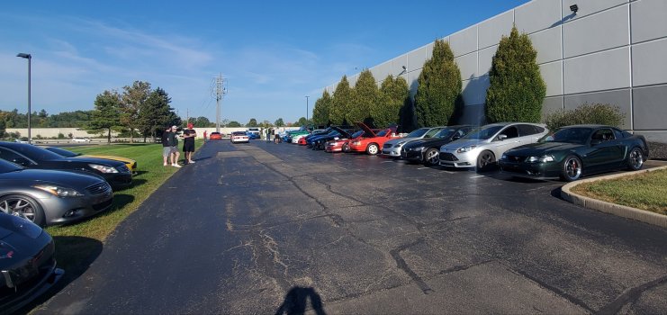

That’s not nice. I’m sure that Acura has a great personality!Drove it to the car show in Lenoir City. There's always one ugly girl at the beauty pageant.
I'd return the grief to the Malibu sport coupe with a fake SS badgeYep, I wont forget getting grief for parking at a classic car event, next to a baby-faced corvette. It was probably just some local though
To be fair though, the roadrunner and the chevelle did raise a bar or two
