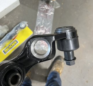

What part of the suspension is this?

I ordered some new front lower control arms and they arrived yesterday, today I stayed after work in the shop to put them on the car but then I realised they didn’t come with the bushing that connects to one of the parts.

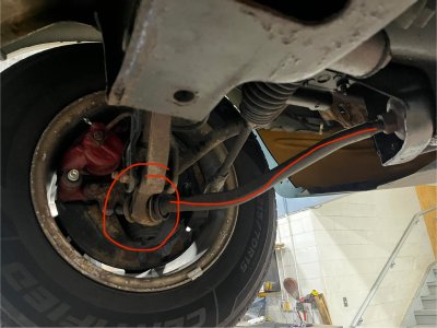

The ball joint and other 2 bushings are there, but there’s the one here missing, I’m guessing it comes with the bar that it attaches to, but I can’t seem to find either the bushing or the bar itself on rockauto.
What is this called? Hopefully I can find one otherwise il just be firing these LCA’s in and hoping for the best. Or just like hoard the parts and eventually use them

As mentioned, they are called strut rod bushings. There are two that will probably be listed: Front to Frame and Front to Arm. You want Front to Arm. As also mentioned, whichever brand/construction you want is fine for the control arm bushings. It is the frame bushings that people have had issues with in the past.
