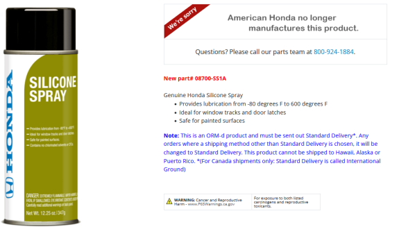

Silicone lubricant spray in the window track will also free them up. Honda actually sells their own branded spray (maybe not anymore) for this exact purpose.

I remember briefly (amazon) looking for the honda spray, but it came up with a squeeze tube ... let me know if yall find the spray
PB Blaster makes some silicone spray that I’ve used with good results. Available at most parts stores.
