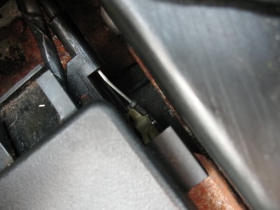

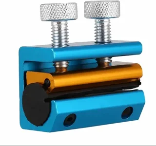

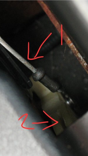

It still think it has to do with the cable binding because of age and lack of lubrication. The issue will go away once the car is warmed up for a few minutes; at that point the cars interior and steering column are still cold. The only areas that warmed up are the transmission tunnel and the engine bay; which is where I assume the cable is routed
