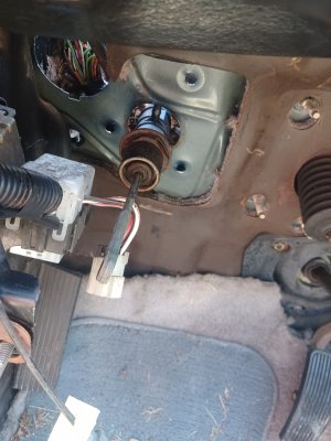

I can get the books out if you want Ford's instructions.
It’s a pretty similar process: bolts across the upper cowl, nuts on the A pillars, and a couple bolts to the trans tunnel. Unbolt the column U joint, unscrew/disconnect the big round electrical connector that goes through the firewall, the connector that attaches to the body harness near the dead pedal bracket and the couple connectors behind the passenger kick panel that connect the dash to the stereo, ARC/ABS and EEC harnesses.
Keep in mind, My video is for removal of the 94-97 dash. The eariler ones are different and not covered in the video. But the videos might help you a bit.

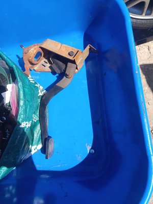

So is the clutch pedal at least usable across all years? Seems TBSCshop has two different ones for before/from '94 iirc; not sure what the difference is.
I was incorrect. They'd be 89-91. Those are 92 and up. They're notoriously difficult to find unbroken. I don't personally need them. You could probably sell that set, but in my experience those are easier to come by.

OP, I have only found early model SCs and I ran an early pedal in my 94 for years. I can't say what the difference is - if any.
There is a slight difference in the positioning of the pedal on the later vs early clutch pedals, but they will all install and work in any MN12, so if someone is looking for a pedal for a manual swap, they won’t care what year it came out of.
The big difference is the brake pedal, 89-92 is basically a auto pedal but narrower, where later ones have a bit of an S bend in the arm that positions it closer to the accelerator.
Pretty rusty. Still valuable?
Do I just need the pedal, or also the mechanism behind it?
Getting the manual brake pedal, too, I imagine.
Just surface rust, that’s how they all look.
The mechanism behind it is the clutch switch you can wire up for cruise control and starter starter safety, I’d actually snip the pigtail to go with it
FYI with the brake pedal the only part of value is the pedal arm itself, you don’t need the “cage” like you do the clutch pedal, it’ll just swap into the auto one, and in the case of 96-97s is what you have to do anyway since it has different mounting for the electric cruise travel switch
Only took the arm. That saved $10.
It’s not really of much demand for them, you need to convert to the handbrake to use it and that’s not nearly as popular to do than the manual swap
