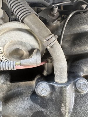

Are these small red and green vacuum lines available anywhere? These rascals were so brittle they practically crumble in your hands.
I assume I could use tubing that size if I strike out and scrap yard.
You could also salvage those tubes from other cars, and not just from Fords either. You can and rebend them with a heat gun
Thank you. Sounds like I need to hit the salvage yards. Thank you
