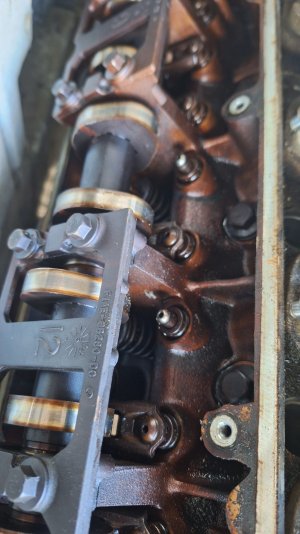

This is what I found after removing the passenger side valve cover. I suppose two missing valve followers would cause a gallop, eh? :)
I have never removed a cam with the cam still in the engine with the timing chain on. Is it even possible? I could probably slip and pry the followers back in without removing the cam but that wouldn't allow me to investigate why they fell off. I suppose if the valves were bent and didn't come back up would explain how they came loose. Also, if these valves were bent and not seated, that would explain a backfire.
Yes, it is possible... there are risks, but it sounds like you know what those are. In your case you could remove the caps and elevate the cam slightly to give you more room to work, without really moving the sprockets or chains. This would be the least risky.
When I did my first PI cam swap I left the front cover on, "propped up" the cam gears with tools then unbolted them from the cams. Then I removed the caps, R&R'd the cams, and reinstalled everything. It worked out... but in hindsight I was lucky. All too easy for the tension on the chains to slack off when moving the sprockets, and the tensioners could have clamped down on me.
OTOH, it's probably worth considering just taking the front cover and re-timing it. That'll also give you an opportunity to inspect the condition of he guides and tensioners.
So is this condition something that is a known issue with the 4.6? I mean...isn't it a bit irregular for a cam follower to "slip off" for no reason? I'm wondering what could cause this and the only thing I'm coming up with is a bent valve where it can't seat. In this case we are talking quite a bit of internal damage, right?
I'd love to be wrong. Anybody know of anything else that might cause a follower to "fall out" of place?
I hate to be the bearer of bad news as well but that’s been my experience. I’ve had a few optimistic thoughts where I’m going “yay I just need to put the followers back and I’m good” only to realize the valves are bent and/or kissed a piston. It can happen through overrevving but not before the stock limiter kicks in. It’s either something happened on the valve end to let them loose or the lash adjuster end (collapsing from lack of oil pressure which is also not good)
I spit one out doing a burnout with a tune with no redline and a pi intake. It's not easy.
My old PI heads I ran had a spit out lash adjuster(or I should say missing) when I bought them. This was why
I had a spare couple valves from a set of junk heads I parted earlier and lapped it and sent it in the end but that was quite the unpleasant surprise
Mine cracked the guide.lol. I bought a pi engine. The npi heads brought 25 bux as recycled waste. :) I break stuff good.
Thanks guys. That's what I figured. I'm not going to be keeping this car (I don't rhink). I have a set of 96 heads I can put on it assuming no pistons have been dinged, but I have a spare used set of them as well. Guess I better pull the heads.

I would think that after seeing two cam followers sitting in the bottom of the head that I know of at least two bad cylinders. I highly doubt that the lash adjusters failed or that the engine was severely over-reved, so that really only leave skipped timing chains, right?

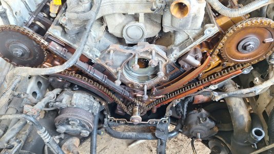

I took the driver's side valve cover off this morning and found two more cam followers sitting in the bottom of the heads. Then the timing chain cover comes off. No apparent failures. I attempt to put the chains in the correct orientation and I got through about 45° rotation and hit a hard stop. Then I went in reverse until I hit another hard stop. Then I went forward again counting the degrees I could turn.
I could only complete about 250° of rotation. Since the motor has been cranked with the starter by both the previous owner and me, I know that there is piston and/or valve damage. I figured I'd be removing the heads from the first time I personally cranked it and heard the gallop.
