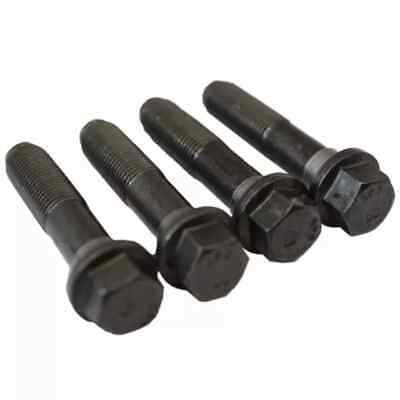

Anybody know where I can get (2) con rod bolts? Can't seem to find only two, just a complete set. I only pulled one rod cap. I didn't remember the bolts were TTY.
This number cross references with a 1995 Ford Thunderbird 4.6 when I checked on Ford Parts Giant.
Yeah, I saw that. Looks like it's $4 and some change per bolt even though it shows 4 bolts. Is that about the going rate? I thought it was a bit much but maybe not...
