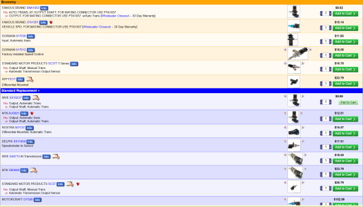

Not sure if a relay went, or if its something larger. I'm hoping someone can help me understand how the wheel speed sensors work on traction control equipped tbirds? My understanding is there are two at the front wheels, and one at the rear diff by the pumpkin. If im correct in that understanding, can someone confirm if the sensors on rock auto would fit, and which I would need? I am not the most mechanically minded. Help is appreciated.
