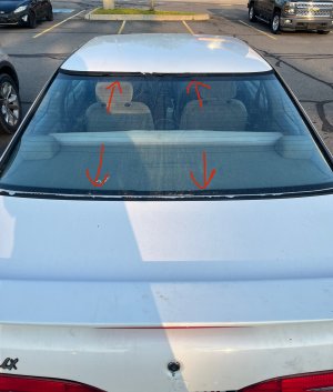

Anyone know what this window trim piece is called?

Do you guys know where I could find this part online or how I could fix it?
The rest of the window trims on the car are in pretty good condition, but these ones have been bugging me since I got it.
The bottom one is easier to get a good finish on because it's entirely aluminum, but the top pieces both have a rubber gasket integrated into their finish that seals up against the glass. Regardless I sanded all of mine down and painted them with DupliColor Trim Paint over 15 years ago, and they still look great.
In my case I didn't sand off the rubber gasket part off of the top pieces - just the top surface that had been peeling/corroding, if that makes sense.
I have an OEM new-in-package upper sitting in my garage in my private stash of parts.
I'll let ya have it for $2,000 .... J/K :LOL: It's not for sale.
But, yeah, the other suggestions that have been given will work just fine.
A strip of this or equivalent would probably work to rebuild the seal on the upper.
This might also work: https://a.co/d/9vficPd
I like this one even better: https://a.co/d/hyy6grl
I’ve painted a few top ones, and after awhile they tend to get sticky.
I painted mine, top and bottom of rear window, with PlastiDip, and both turned out oddly sticky, which has never happened before with PlastiDip.
I sell these pieces occasionally when I find nice junkyard units; they always sell the same day.
My own pieces look fine in spite of the stickiness.
I managed to replace the top in this thread:
With the caveat that the guy wasn't 100% sure which piece it was that he used to do so; you'll have to do a bit of digging. But it works great.
So the lower trim wont cause any leaking and can just be painted? Mine starting going last year
Correct. None of those pieces contribute to the watertightness of the windshields; they're purely cosmetic.
