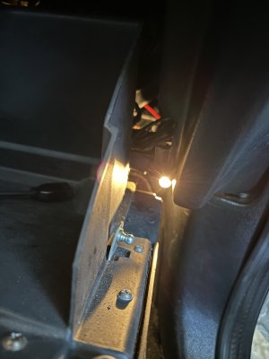

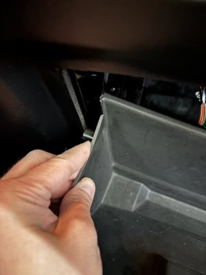

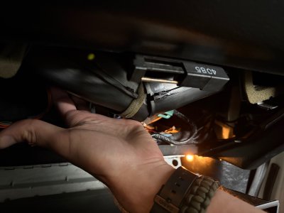

Now let’s dig in, first you want to drop the glove box, not remove, just open it extra wide, and you can do this by first unhooking the shock on the right side of it (only of you have a 94-96)
and then pushing in the right side for the tab to clear the dash core

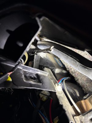

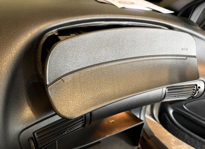

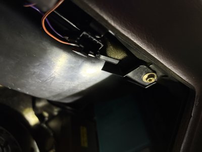

Now what you want to do is look inside above, you’ll see a plastic ducting system to the AC vents, you want to remove this, there is a Phillips screw in the middle holding the halves together and three 7mm screws holding the ducting to the dash frame, remove them all
Now that those are out drop the ducting down like this, which will allow you to separate the halves to fully remove them

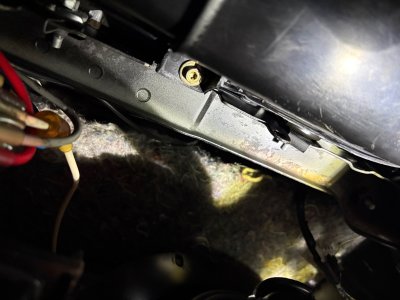

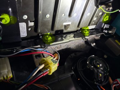

With the ducting out of the way you now have access to the 4 8mm passenger airbag mounting bolts, highlighted in green. Remove all four

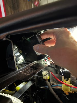

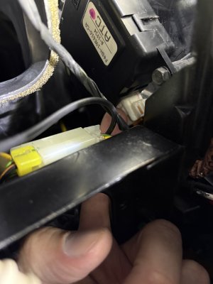

From here you can pull out the airbag and disconnect its connector(again I hope you disconnected the battery!)

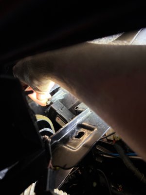

Now you might have noted a big gaping hole in the dash without the airbag, and if you peer in looking towards the middle you might be able to spot the target blend door actuator

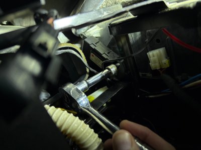

From here you’re going to need a 8mm combination wrench, unless you have 80s Schwarzenegger arms you can reach in through the hole, unclip the connector and with your wrench to get at all three blend door screws. Pro-tip, it usually only takes a few turns with the wrench to get the screws loose, where you can remove them by finger for the remainder(same with reinstall)
Now that you’ve taken the screws out simply pull it back and remove the blend door actuator

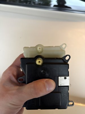

With the actuator out of the dash, the blend door if not in the position already will have fallen into the “cold” position. The actuator in the cold position should be keyed like this
If not you’ll need to adjust it, using wires from a battery to either pins 7 and 8 to adjust the motor to the actuator( reverse the polarity if it’s going the wrong way)
