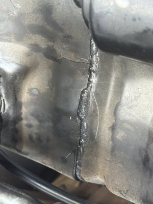

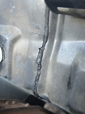

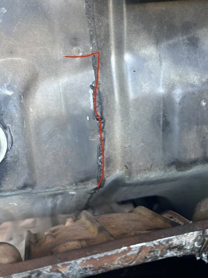

I did notice this crack in the engine bay tho, I’ve heard of these cracks happening right in the center of the engine bay. I’m pretty sure this is going to keep spreading.
Is the solution to weld it up?? Kinda bummed I found it right there, pretty hard to get to once the engine is in.
Pretty sure that's a factory seam, with seam sealer in it. You can weld if you want, but adding a bit of sealer would work too.
To fix cracks in metal like that you drill two holes, at the ends of the crack, then weld it up.
Drilling the "stop holes" keeps it from getting bigger; welding it up makes it stronger.
I don’t have access to a welder in my parking spot, for now can I just drill those holes to stop the cracking and the ave it like that til I have the space for it?? Also what size hole should I drill??
Hard to tell where the crack stops. Does it split at the end? I would think 5/32"-3/16" would be fine.
Thanks for the tip. From the looks of it, it seems like it it’s an L from the very top and it goes Str8 down. Do I drill on the very end of it on the left side, then on the bend when it goes down and all the way at the bottom, or just the very top left and the very end at the bottom?
The vertical part isn’t a crack, that’s just the firewall seam
You sure?? It looks like that sealer is “ripping” along that seam. If that’s the case I’ll just go ahead and drill those 2 holes on the horizontal crack.
Are there any guys around you that do mobile welding? I would have to think somebody near you does something like that. It will be much easier with the engine out. Obviously you'll need to take precautions that you don't set your interior on fire.
I assumed it was just the horizontal section that was a crack and the vertical section was a seam between panels.
To me it seems like the vertical seam sealer is showing signs of cracking also. I’m thinking I’ll just wait on the crack fixing for now because I’d rather take the whole dash out and do it the right way. Is there a fix so this won’t happen again? Bracing or something??
Be mindful of what is on the other side of the firewall if you decide to drill....
Haha I didn’t even think of that, gonna drill right through the heater core 😂
I don't have them on my car, but I think these two braces are supposed to help with that. The second requires pretty minor welding. They honestly don't look too bad to fab up yourself if you were so inclined.
I don’t think the seam sealer is cracking I think it’s just sloppily applied. If it were cracking you’d see additional metal cracking at that other spot weld below that’s perfectly intact. The whole joint is kind of sloppy from the factory, it’s not even welded where it attaches to the floorpan/tunnel, just pop riveted!
As for how to prevent it? LECB braces won’t add any torsional rigidity if that’s what causes these cracks so it might be peace of mind but it’ll be specious. I honestly don’t know the true forces that cause them, I’ve seen cracked firewalls on low mile “grandma only drove to church on sundays” cars and intact ones on cars like mine (knock on wood). They might crack from flex or they might crack from simple expansion/contraction as temperature cycles.
I agree, don’t do anything hasty to cause a a bigger issue(like setting the insulation pad on fire from the welder lol)
I actually have both of those braces on the bird currently and it still happened. I honestly don’t like how the SCP LECB welds with a lil tab to the frame it doesn’t seem strong enough.

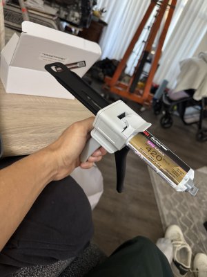

Dang, I kinda figured that area was just weak sauce. I bought some 3m dp420 epoxy that’s supposed to be a really strong adhesive. I’m hoping it’s strong enough to bind that area together without having to weld it, if it won’t work that project will have to wait til I can park this sucker and remove the dash and legit weld it up.
Drill the stop holes, and epoxy a plate across the crack; if it keeps flexing, it will break the epoxy, but it'll give you a clue how bad it is.
Sounds good thank you for the advice
I don’t know how strong that 3m stuff is, but if you really want to stop it without welding, do like Greg says with the plate, but use Lord Fusor panel bonding adhesive. Once that stuff cures, not even god can get it apart!
I’m pretty sure that stuff is like the 3m panel bond, which cures with a lil bit of give to it. The 3m dp420 I got is epoxy and cures solid. If it cracks the plate for sure there is some serious pressure going on there.

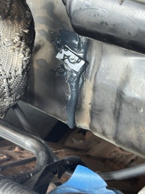

Also also mix the crack on the firewall is alot longer than I thought, it’s goes from the very left to the center and the it goes down. Pretty much those 2 spot welds aren’t doing anything, so I think I’m going to stuff the epoxy INTO the seam and hopefully that helps.
Applied the epoxy yesterday and it finally dried up today, looks solid. Let’s see how long it lasts.

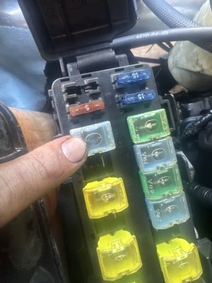

Also got the bird running today but I blew the coil pack fuse which is weird. Had to jump it with some wire to get it to warm up. Gonna hit autozone and see if they have that weir ass fuse in stock.

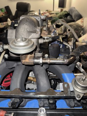

So I got the bird running today, sounds nice and healthy. Was kind of nervous of my engine building skills but it seems like it’s running great.
Only 1 problem, it seems to be leaking from the bolt hole I drew the red circle around. It’s the SAME leak that killed my last engine.
So I removed the bracket and ran the engine NA and it didn’t leak (with no bolt either). Pretty weird, does anybody know if they require silicon on the bolt?? Pretty bummed out that leak persist, my next step would be to remove the bolt, silicon on the threads and some shell lock on the timing cover.
Any tips??
