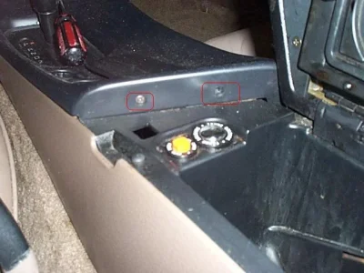

    Start by removing the center console. If you lift up the lid of the console you will find 2 screws in the back edge of the console trim; remove them.

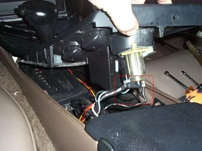

    Next lift up on the console piece you just removed the screws from; there are several clips holding it in place as well as a wiring harness powering the lighter. Note the trans will need to be in 1st for proper clearance to remove.

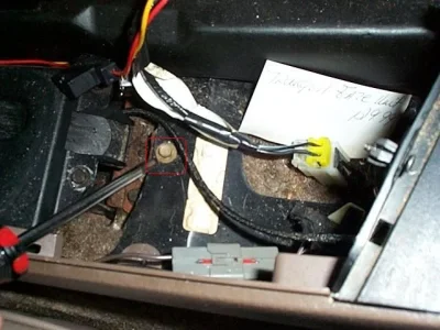

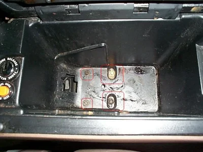

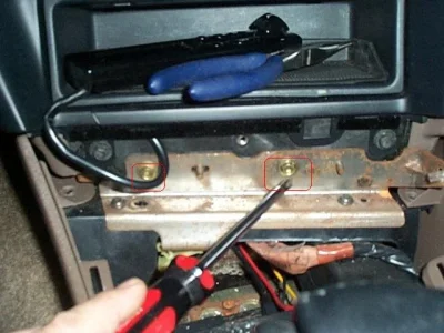

    Lift the lid again and remove the rubber liner from the bottom of the storage bin, underneath you will find 4 screws; remove them.

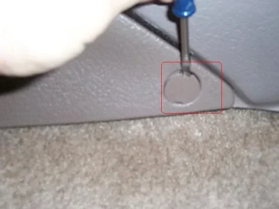

    Next remove the 2 screws holding the front of the console to the dash as well as the 2 screws on the front sides of the center console hidden under the plastic caps. Last but not least remove the 1 screw in the center behind the shifter.

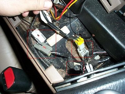

    Next disconnect the wiring harnesses that power the trunk release, gas cap release etc.
    Lift console out and set aside.

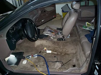

    For the next steps I found it easiest to first remove the drivers seat. There are 4 bolts holding the seat track to the floor.

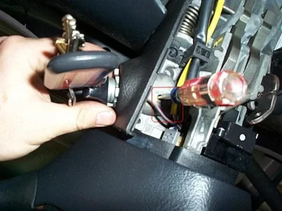

    Remove the ignition switch lock cylinder by inserting your key, then push in the release pin on the underside and pull straight out. Now the upper shroud will come off.

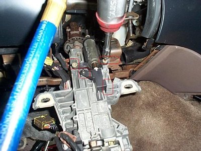

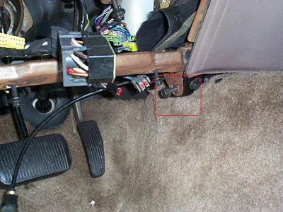

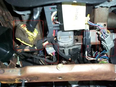

    Disconnect harnesses at the base of the steering column. There are 4 snap connectors and one main one secured with a bolt.

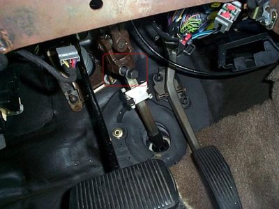

    Remove the pinch bolt attaching the steering column to the lower yoke and use a screwdriver to slightly spread the joint.

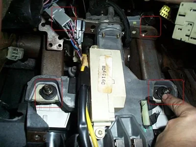

    While supporting the steering column remove the 4 retaining nuts; be careful not to drop the column on your head.
    Now with the column lowered remove the shift interlock cable. Note these 4 screws are star type.
    Gently remove the column from the car being especially careful not to rotate the wheel.

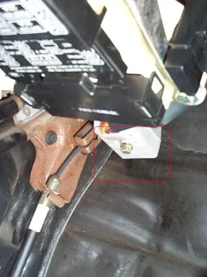

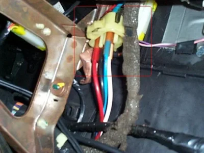

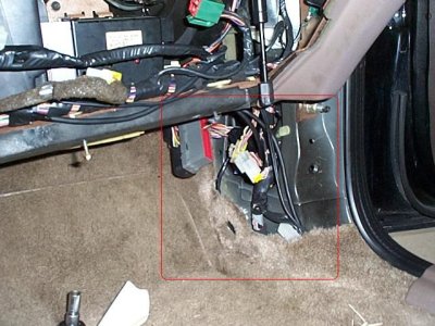

    Disconnect the main harness just above the emergency brake bracket and also disconnect the wires leading to the brake light switch.

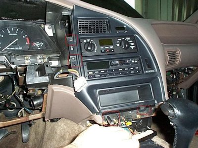

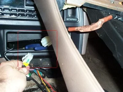

    Remove the trim panels from around the gauges and around the radio.

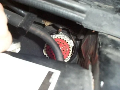

    Disconnect the main wiring harness at the firewall on the driver’s side by undoing the bolt and pulling the connector backwards. Release the 3 clips holding the other portion of the connector to the firewall and push into the interior.

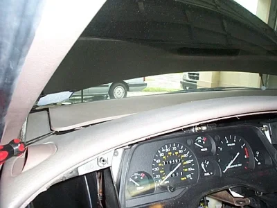

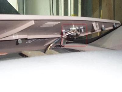

    Next using a screwdriver carefully pry up on the defroster panel until all the clips holding it are released. Unplug the sunlight intensity meter and remove defroster panel from the car.

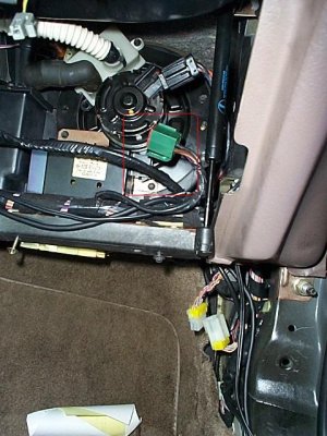

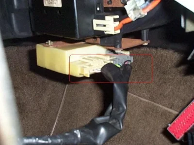

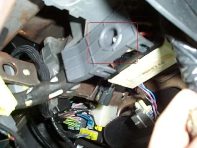

    Unplug and remove the EEC and disconnect the harnesses around it behind the kick panel.
    Unplug the harnesses and vacuum connector running to the climate controls.

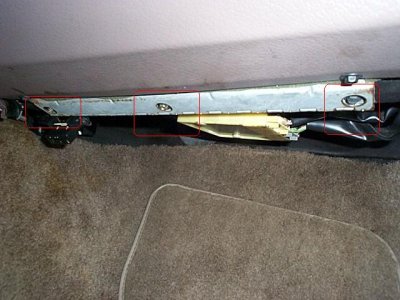

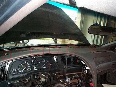

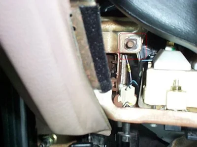

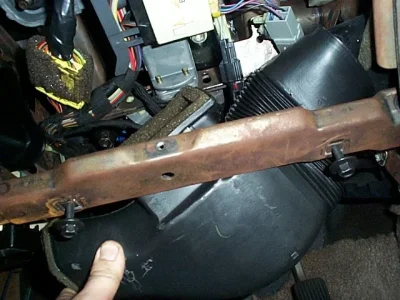

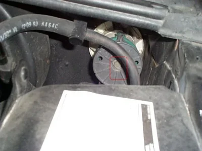

    Remove the 8mm bolts underneath the defroster panel. Be VERY careful not to hit the windshield with your wrench. Consider wrapping it in a rag or towel as a precaution.

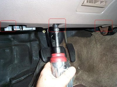

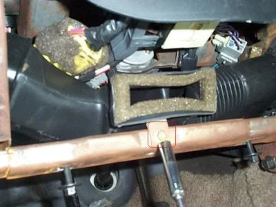

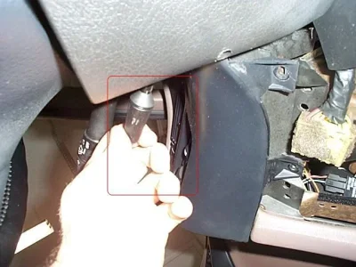

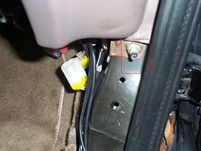

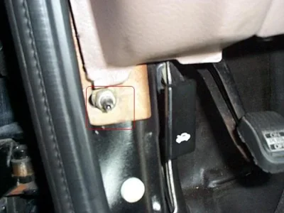

    Remove the 5 nuts at the bottom of the dash.
    2 on the driver’s side
    1 on the tunnel above the gas pedal
    1 in the center section below the radio
    1 on the passenger side

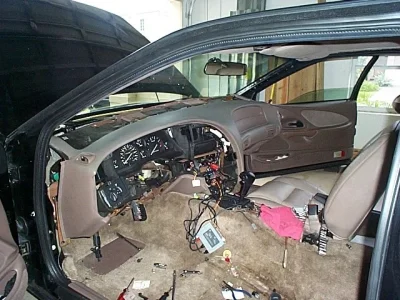

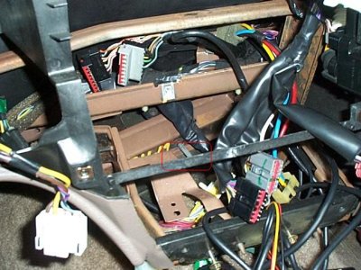

    Now you need a friend to help. Lift and pull back on the dash until it is 6” – 12” away from the firewall.

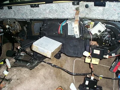

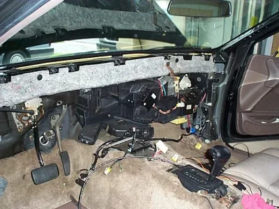

    You can now get to any remaining harnesses behind the dash and also the radio antenna. Once you disconnect any remaining wiring you can carefully remove the dash and you will be left with something that looks like this.
    Replacement is simply the reverse of what you just did.

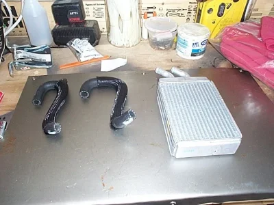

    Sir William’s instructions for removing the heater core without discharging the AC worked like a charm. Consider buying new hoses to run to the heater core since it is sometimes easier to cut the old ones out of the way.

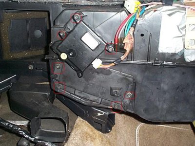

    Remove the actuator door motor and heater core access panel.

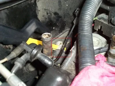

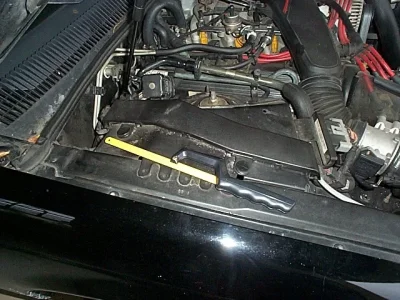

    Using a frameless hacksaw cut the heater core tubes as close to the firewall as possible. Believe it or not this was one of the tougher steps in the whole process.
    Pull the old core out through the access panel.
    Make sure to clean heater box where the core came out good; it will be plenty messy in there. Next cut a slit in the foam rubber gasket in the firewall starting at the hole closest to the center of the car through to the other one and continuing to the outer edge of the opening. I found this easiest to do by sticking my hand inside the heater core access area but I have small hands and others may find it easier to cut from the engine compartment side. Now you can just push the new core in and through the firewall. Replace the access panel and blend door actuator motor.

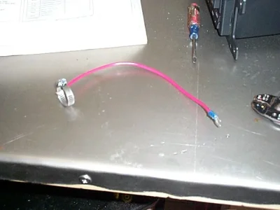

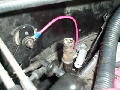

    What comes next is optional. Ford once recommended that a grounding strap be added to the core to prevent the aluminum from breaking down due to electrolytic corrosion. The TSB specifies copper but I have a problem with that since aluminum + copper + moisture = a battery and the copper would tend to wear away the aluminum where the two are in contact. With that in mind it is advisable to use pre-tinned copper wire or if you can’t find any tin it yourself by coating the end that will be in contact with solder.
    Clamp one end of the grounding strap to one of the heater core tubes and then attach the other end to an existing bolt on the firewall.
