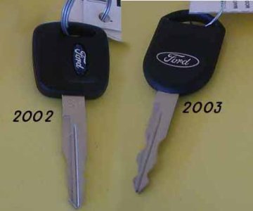

These are 8 cut keys so they would work tbirds/cougars that are 06/96 and up. And never post pictures of your key I can decide and cut keys just from this picture so I hope this is just a random image which I'm guessing is the case unless you have a newer tbird based on the years next to the keys.
