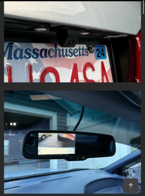

I run a cheap Amazon back up camera to my radio, it’s very discreet, I can’t remember if I posted in here or the old forum. Let me see if I can find it.

The main deterrent currently is the smallness of the OEM backup display which is only about a quarter of the mirror surface, as opposed to that aftermarket unit where it's closer to half.
