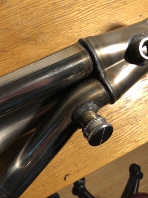

Splash some anti-seize on those threads in case you ever have to take that cap back off in the future. I like to use the Motorcraft high temp nickel anti-seize for exhaust, but anything is better than nothing.
For 304 stainless? I mean I liberally use antisieze on literally every thread on my car that’s not saturated in oil but I figure this should be more than ok as is. In general I’ve never used it on EGR tubes and never had any problem getting them off even in rusty cars apart from wrench clearance, though I guess with this cap and its knurled ends it could pose some more challenge if it gets stuck
The words stainless and threads always makes me shudder. The threads can gall. As you do, I coat everything I touch on my cars in anti-seize. If you are ever looking for investment opportunities, look for companies that make anti-seize. I would buy it in 5 gallon pails if they sold it like...and holy crap I think I just found some. https://www.actionis.com/loctite-re...ize-lubricant-5-gal-pail-paste-gray-1-1?gQT=1
Dang, you're like the P Diddy of the car world😆
I'm not really sure what that means, but if he is obsessed with keeping rusted car parts from permanently fusing together so they can be repaired at a later date, then I'm your man.
I mean I’ll just throw some antisieze on just because, but I've been using SS hardware on my exhaust since 2010ish(?) and I never bothered with the antisieze on those for the facts that they were stainless and if they did seize in the spots I placed them I could cut them off easily, but I've never needed to do that.

Like I said I'll just throw some on there, I've always got a bottle of antisieze at arms reach at all times and am not afraid to use it, but I just don't see how this grade of 304 stainless is possibly fusing together:zshrug:
Stainless gets 'porous' when it gets hot, it's not like normal steel. Could be worse,Titanium is twice as bad,lol. I'll never let oscar forget about making those, lol.
I'd just like it known if I seem naive about header/metal properties in this thread I learned it all from Oscar lol
I didn't know shit about stainless until I got a job working with it everyday. a 1/4-20 bolt will twist off easily if you forget the antisieze. Getting that piece out of a $250 flange before the boss sees your fuckup is a bitch. Not a mistake you make twice.
