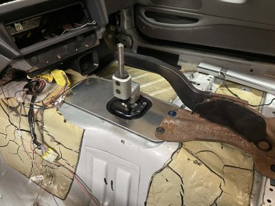

I found em on the FB group, pretty sweet bird. He hasn’t posted much on it but it seems like a coolish swap, it looks like the shifter even might fall right into the stock location without needing to make a remote shifter.
Thanks 🙏

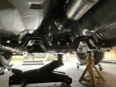

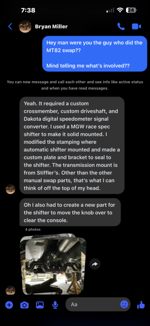

That guy replied to me and it seems like it’s a lil involved, besides the crossmember and driveshaft everything else seems pretty Str8 forward. For sure the 4.6 won’t break it, it doesn’t make coyote power AND it doesn’t rev up that high compared to the yote either.
View attachment 16444View attachment 16445View attachment 16446View attachment 16447

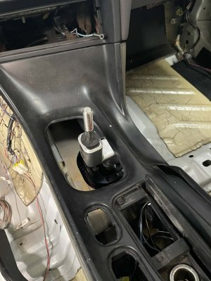

Some of that you’d need regardless; custom driveshaft, speedometer converter, custom tunnel plate etc. with any trans swap really. I forgot he needed the custom crossmember but remember that pic now… it’s not terribly difficult to make as I did as well (primarily for more exhaust clearance). The shifter offset could probably be improvised with spacers and some methodical butchery (keep in mind he’s an engineer, but there’s always an easier way 😆 )
@XR7-4.6 i rather like his shifter modification, i thought it was a part of the MGW kit haha, your boy got some skills. That said, I’m pretty sure that 6 speed must keep the 4.6 always in the power band, plus it’s lighter than the 4R which is also a bonus.
