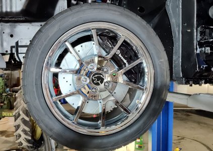

If you used the same color I did, it's a bit more pale than Bilstein yellow but it's close enough.
It is very close yellow, yeah. Not perfect match, but a pretty good match.

You may want to check rotor and pad price on 2014 GT500b rotors and XTS V pads versus the J55 stuff. I didn't think I spent much if anymore to go to the 14" setup. 1000001283.jpg

You may want to check rotor and pad price on 2014 GT500b rotors and XTS V pads versus the J55 stuff. I didn't think I spent much if anymore to go to the 14" setup. View attachment 14213

Wheel and brake combo look great BTW! Did you get the calipers powder coated?

I did a complete tear down and sprayed them with rattle can caliper paint, then engine gloss clear. I would say that I took them down to far, as you can't see the insides. Was way more work than it needed to be. I wouldn't powder coat due to that time involved with tearing them down.
