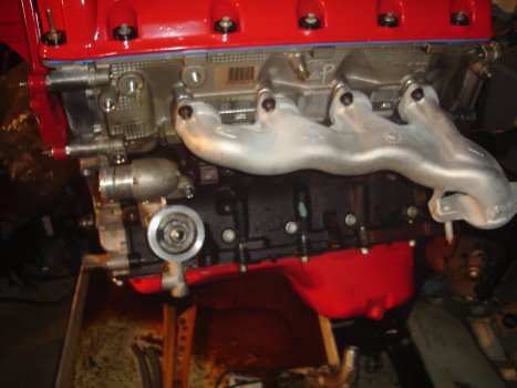

    I'm outside today, pumping gas. I need two an10 lines and fittings to finish the oil filter relocation. And I bough a forged lifting loop. That mounts on the k-member, beside the motor mount. I run a chain from a bolt oon the head, for the lifting plate to pull the engine. "there are two factory plates, that bolt onto the heads with 12mm bolts, 2 on each head." None of the ones on ebay currently are for us, if you lift from our manifold, it would rip in half before it would come out. :)
    Man, the 10 buck plate I bought for the oil filter relocation is getting expensive. AN 10 lines for the oil are $100, lol. I can build them for half that, but oil is too critical for me to make the lines. What do Y'all think?

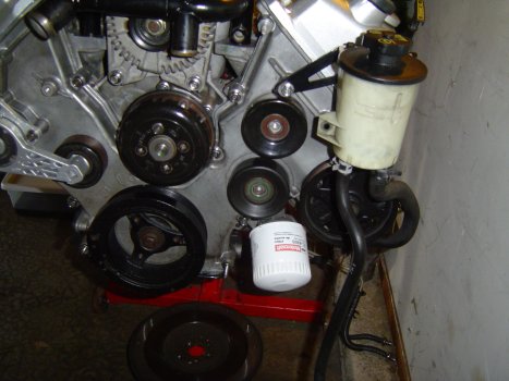

    jeezus!! that's exactly the perfect mod. much cheaper than my path. Does that mod require the front cover?
    Yes, since the timing cover has two of the four bosses to mount the power steering pump to the head instead of the stock block location Plus the extra pulleys are necessary.

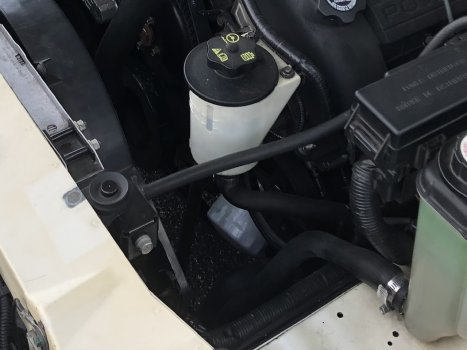

    Hey you get that Volvo EPS pump working you won’t need to change timing covers or move the PS pump at all :biggrin:
    I'm still working on it. I bought a programming package for the PIC setup I have, and I bought some canbus stuff to work with, that came with a manual, so I know how to talk to it. The fact I don't have that working yet is actually encouragig. There's obviously something I'm missing. Any experts in pic coding, I'm happy to post code to be laughed at, lol.

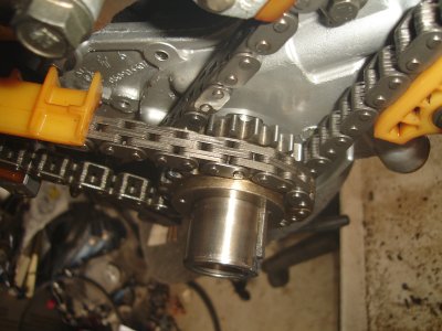

    I Foun a photo that explains why I replaced all the front cover stuff in the '03 engine. I saw the car it came out of, and the rear bumper was in the back seat location. :(
    Zoom in on the gear teeth. This engine has 725 miles on it, I looked at the car.
    No squirters on the Plastic tensioners makes the chains slap around, and the Sliders were Twice as worn as the old ones out of the dead npi. But it donated its iron tensioners, :)

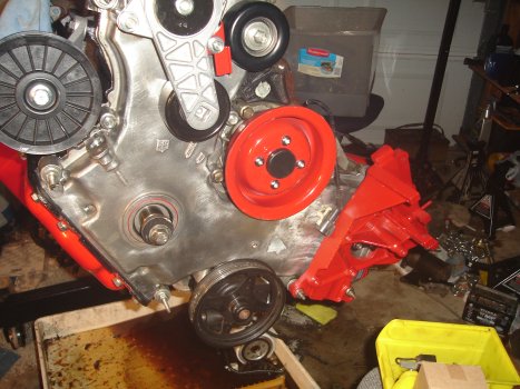

    I swapped the old gear with a new one piece, and the stamped trigger wheel. And all new sliders, of the new material. Nick advised, and made me a kit.
    In te meantime, I bought a plate to replace the oil filter adapter, and a relocation filter holder. Lines are an10, which was cheaper; they were cheap enough, I decided to do the fuel rail in that size. I misdrilled the an-6 line sized extrusion; my ocd won't let me use it. I'm using the same teflon/stainless line for the oil and fuel.
