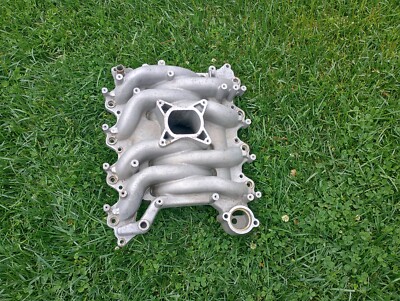

Typhoon is just an aftermarket intake made by Professional Products. It kind of looks like an aluminum copy of the real plastic PI intake, but it allegedly does not perform as well.
