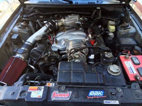

You also have to flip the alternator backwards for the Trick Flow, which results in a slightly more direct airflow path but it’s not a pretty sight..,
That intake looks great, love the aluminum up top. Would look nice with some matching valve covers.
In that picture if the alternator along with everything else under the hood was cleaned up it would look alright. Whoever's car that is, keeping a clean engine bay was not on the priority list.
