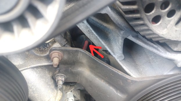

What is this single wire suspiciously loose connector aft/inboard of the power steering pump?
That's the oil pressure switch.

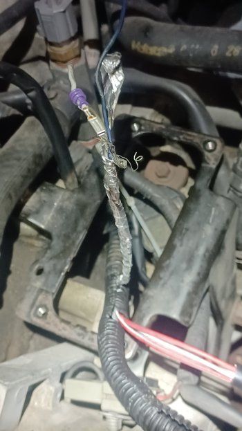

Take the wire loom off that section of the harness and cut off/replace as much of the wires up to the connector as you can. Replace the connector and pigtail if you can find a good donor. It's entirely possible there's a short in the harness that vibrates and/or heat-creeps itself into and out of continuity. There's no good way to test the harness without a load on the wires - a basic continuity test won't show if there's a short that fails with current on the wire.
Are you running Android? Check out Torque app. Even the paid version is cheap and gives alot of data logging info.
I went in there last night...but sort of lost patience and put it back together. No obvious damage. I didn't take off the shielding because I have no new to replace it with.
The shielding has an uninsulated ground wire running through it, which looks messy but doesn't seem like it could cause any harm.
This morning the car runs normally. I went for a short drive around the neighborhood.
Should I just forget about it until the next episode?
that wiring looks a hot mess. what is it actually connected to? the white wire with purple around it? and the metal sheathing?
@Kidd-7
It's grey and blue for the crankshaft sensor. They go directly to the large connector on the firewall passenger side. The shielding ground wire, I'm not sure where it actually connects to ground.
And the general messiness of it is by design. Just looked at a harness on a Mustang, and it looks exactly the same.
