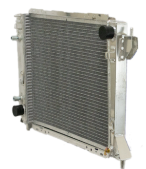

I have an 89 T-Bird SC, building a drift out of the chassis, currently swapping a 5.0 into the car. Now the fun, my radiator is split at the top. I’m currently looking at my options, who’s played around with fox body or SN95 radiators for replacements? The dimensions in the picture are for an SN95. Any help or insight would be greatly appreciated!!

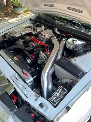

I'm using a
Mishimoto aluminum cobra 3 pass radiator. It's a bit big for the bird, bit I got it in. Had to make brackets.​
I can’t speak for the aftermarket options but would assume the same; I have a factory 03-04 Cobra radiator in mine. The changes I had to make was to widen the two lower mounts as well as to flip the top mount brackets upside down and get creative with the driver side one, which I simply removed the alignment tab of and used a piece of metal with a hole to sandwich the mount on that end.
