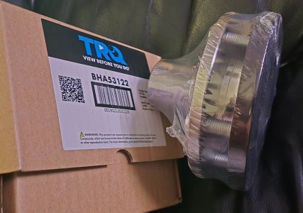

You can still get the 5x108 hubs new aftermarket from a cursory look, here’s one from the jungle site below. The Ford made Cobra ones are the ones you can’t get anywhere other than the billet custom ones from full tilt boogie

TRQ is the only brand producing these hubs? I couldn't find any in canada, so ebay canada had some which will come up from the states. Not bad price 90.00 american dollars delivered. I think it was 138 canadian.
I ordered one.

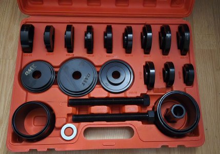

Did you make your own jig for pressing the bearing into the knuckle and the hub into the bearing?
